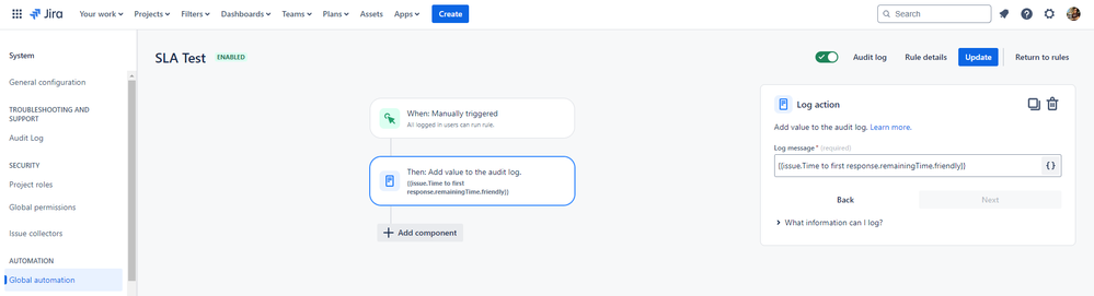

I created a test rule where I was simply writing the value of the issue's remaining SLA time to the automation log, just to see if the info could be obtained.
Here's the smart value I used:
{{issue.insert-rule-name.remainingTime.friendly}}
e.g. {{issue.Time to first response.remainingTime.friendly}}
Here's some great documentation that helped me figure out this format: https://confluence.atlassian.com/jirakb/how-to-find-smart-value-of-sla-component-of-jsm-issues-1167828367.html
Here's the test rule with the smart value written to the log.

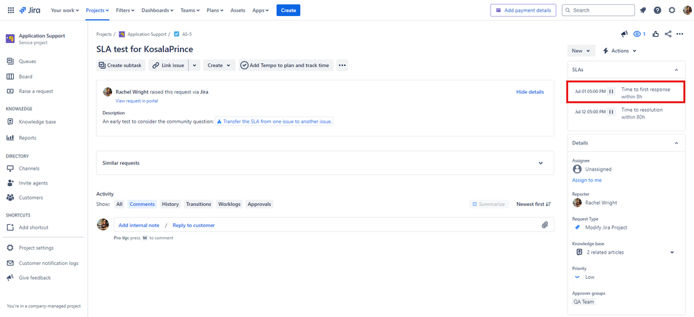

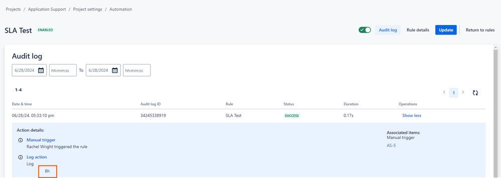

Here's the result in the log, proving we can at least access the needed info.
And here's the related Jira issue to compare the result in the log to.
