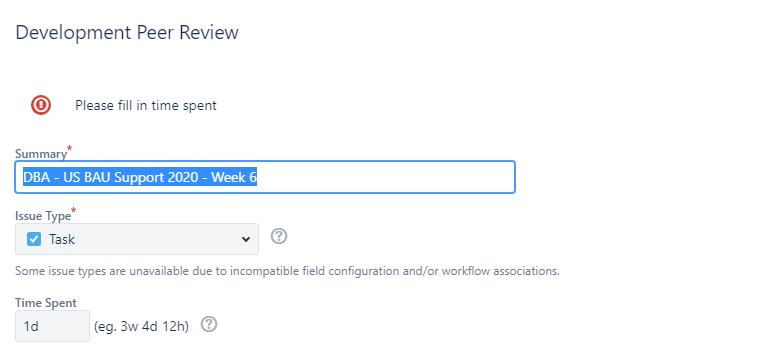

I have used the "Time Spent" field for Field Required validator and the "Log Work" field for the Screen to ensure engineers input the time they spend on tasks when transitioning tasks.
However, I cannot progress past the screen when testing as it thinks I have not input a value into the Time Spent field (even when I have - see the pic below)

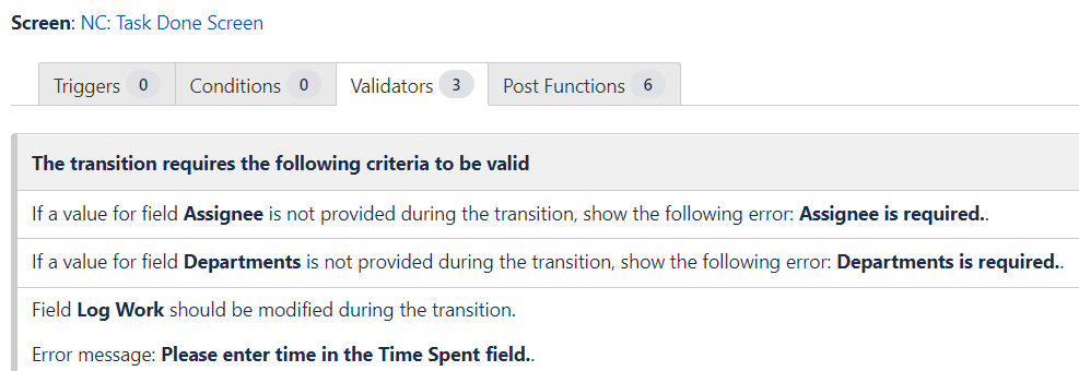

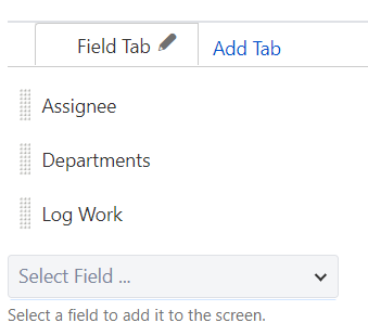

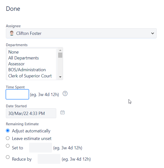

I got around this by adding a transition screen (NC: Task Done Screen) with Log Work in it. I then added a Validator "Field Log Work should be modified during the transition." I did not check for previous Time Spent value but just required a new time entry. Here are the screenshots from my implementation. All that needs to be done in the transition screen is to fill out the Time Spent field (and the Assignee and Departments in my case).
Transition Screen - NC: Task Done Screen2022-03-30 16_34_49-Done - Jira.png
Transition Validations
Transition Screen Fields
