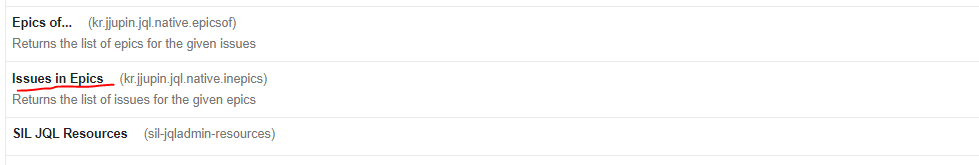

Hi try it:
string jql = "key in issueInEpics("+ key +")";
https://confluence.cprime.io/display/JJUPIN/Pre-defined+JQL+functions

Thanks! But we don't have this function.
As I understand it, it is available in version 4.1.1. Power Scripts. We have version 4.0.2.

maybe they are disabled.
Helen Porter
February 4, 2020
I checked, we don't have such a module.
