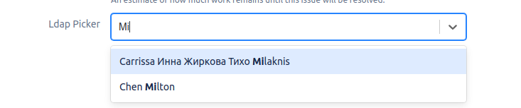

I tried with our embedded LDAP implementation. and it seemed to work OK:
This means it's probably not an issue with the front-end component.
Possibly it's something to do with https://docs.microsoft.com/en-us/previous-versions/windows/it-pro/windows-2000-server/cc961766(v=technet.10)?redirectedfrom=MSDN , but it's not clear to me how to fix it, nor why it would work correctly when viewing the issue.
