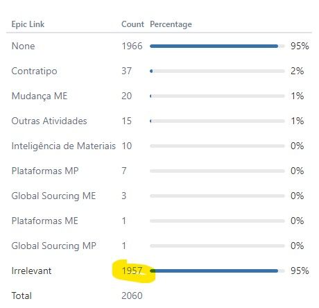

Hello,
I'm using Classic proojects and being seeing this Irrevelant category shoing in gadgets.
By clicking in the number of Irrelevant issues Jira sends me to View Projects screens instead of showing the issues, it also brings me to a wrong Total number

Bill Sheboy
May 27, 2022
Hi @Pedro HS Cunha
The built-in gadgets have apparently not been improved/updated in more than a decade, so I suspect this is not a recent issue.
More likely there is some ambiguity with your filter whereby the "Epic Link" field is not present for those issues.  Would you please post your filter for some context?  Thanks!
