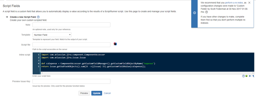

0. Install Scriptrunner
1. Create custom field expense of number type
2. Create custom field total expense of scripted field type
3. Go to AddOns find scripted fields and push edit for total expense field.
4. Choose number template
5 paste the following script
import com.atlassian.jira.component.ComponentAccessor
import com.atlassian.jira.issue.Issue
def csExpense = ComponentAccessor.getCustomFieldManager().getCustomFieldObjectByName("expense")
return issue.getSubTaskObjects().sum{it ->((Issue) it).getCustomFieldValue(csExpense)};
5. put total expense on the view screen of a task
6. put expense field on create, edit and view screen of sub-task.
7. fill expense field for a sub-task and total expense for the task will calculated automatically.

Just to make sure im one the same page.
I created a new scripted custom field called "Total Expense" and placed it on the story view screen.
I went to script runner and found scripted fields where i located the Total expenses field.
I then selected the the number field option from the template drop down.
then i copied and pasted the following.
I created a new sub task and entered the number in the expense field.
I refreshed the story and....nothing happened:(

Alexey Matveev
November 30, 2017
Did you create expense field? how is it called expense or Expense? it is case sensitive. In the script it is expense
Scott Federman
November 30, 2017
it did. it is Expense with a capital E.
Scott Federman
November 30, 2017
I update the script with the uppercase e and it works:) Thank you!
