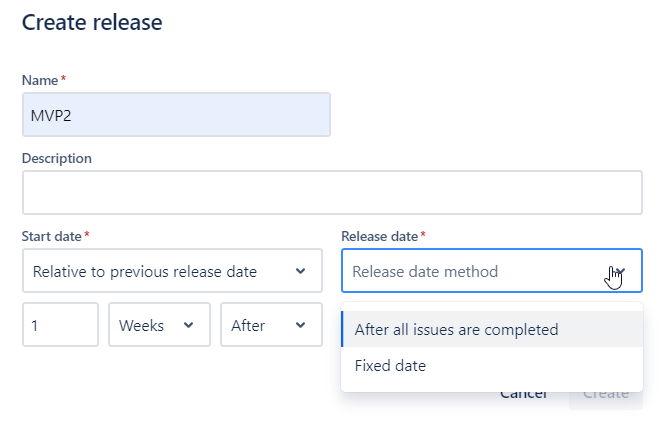

Do the release dates move when the proceeding releases are delayed?
Walter Buggenhout
November 21, 2023
Hi @CC,
Yes, when you create them from Advanced Roadmaps and set them as dynamic, they do:
2023-11-21 09_44_06-Releases - KCS _ Agile WoW en Jira Software - Advanced Roadmaps - Jira SANDBOX.pngYou can configure the behaviour of both start and end dates as you like.
