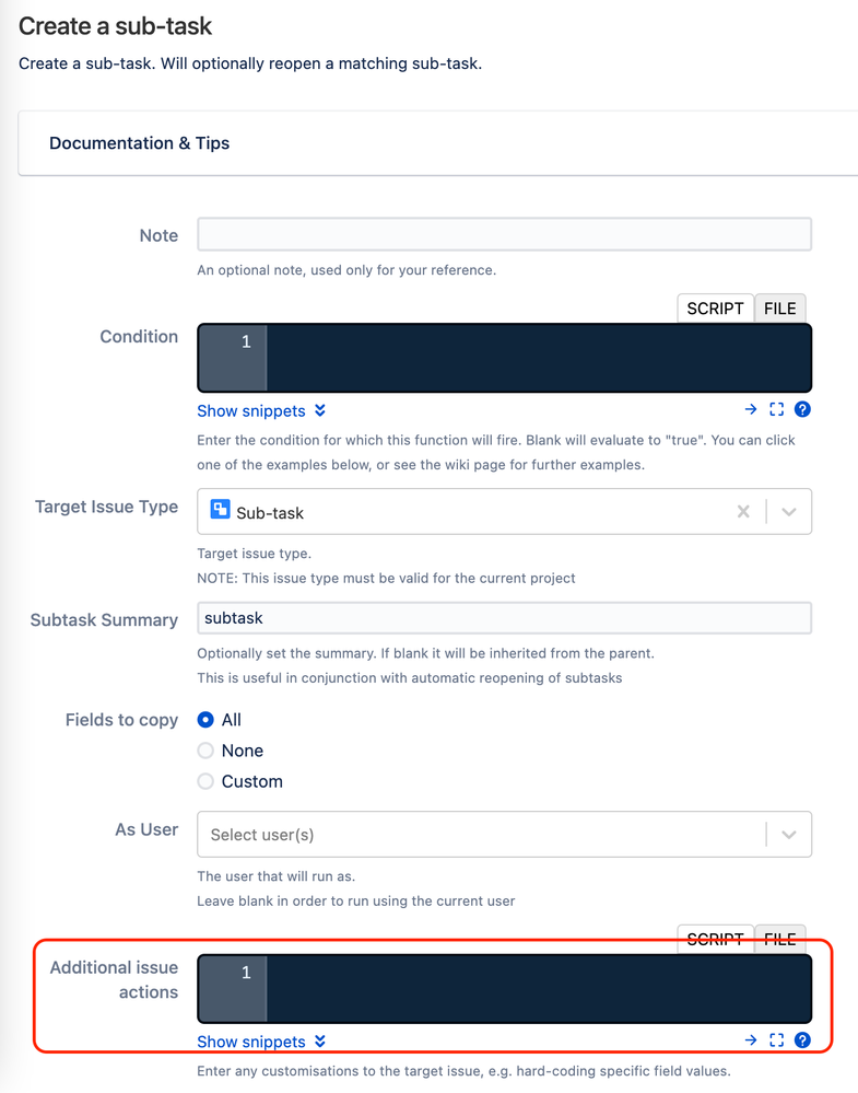

Hi @sm.park ,
It could be the clone and link issue post-function only recognise the parent issue id.
You can try this option by putting the clone issue script in the "Additional issue actions" field. So, when the create subtask post-function executed and clone and link the issue to the subtask automatically.
(disable the clone and link issue post-function while testing)
In the clone and link issue script, you can retrieve the subtask issue key and apply to the script, for example:
def issueToCloneKey = "PROJA-1"
to
def issueToCloneKey = issue.key
I hope this helps.
