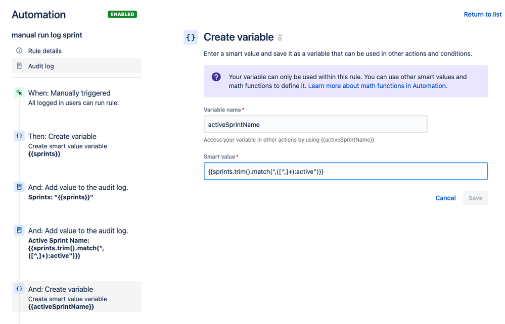

I've managed to accomplish this through some trail an error. It's not as flexible as you've requested, I'll leave that as an exercise for the reader.
The basic gist is to use a combination of smart value list interpolation and create variable action to print out and then extract the active sprint name. Grabbing any other value from the active sprint object would also be possible. Your question indicates that you know how to lookup the values within said object so I'll skip that explination.
Here are screenshots of what you want:
Create a variable to store the sprint names and state information as a string.
Log our regular expression to be sure it extracts what we expect.
Create another variable with the extracted active sprint name as a string.
Add a comment to an issue, just to be sure we can actually use this information in some meaningful way.
A look at the resulting audit log.
The comment was successfully added.
