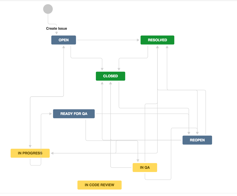

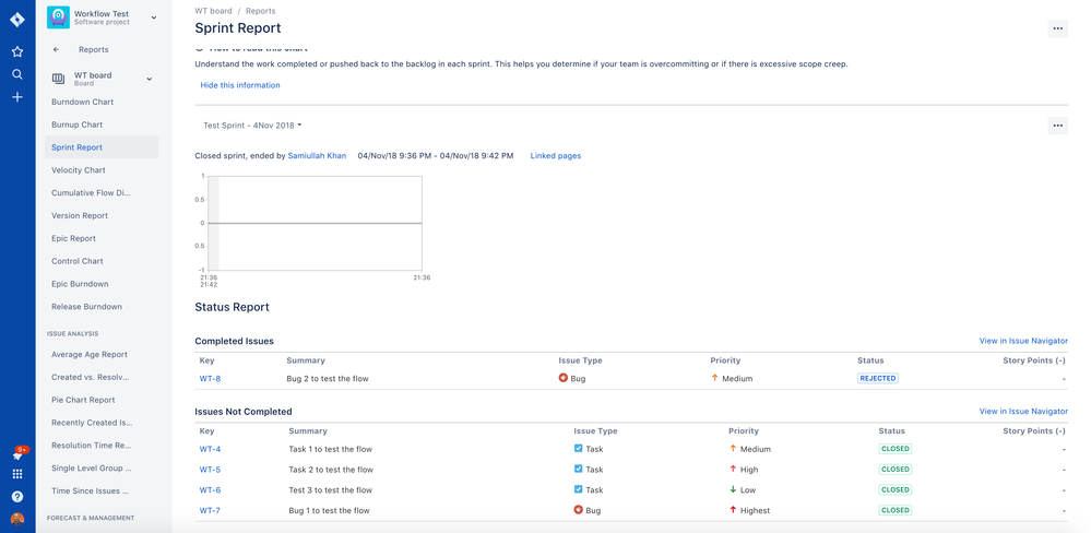

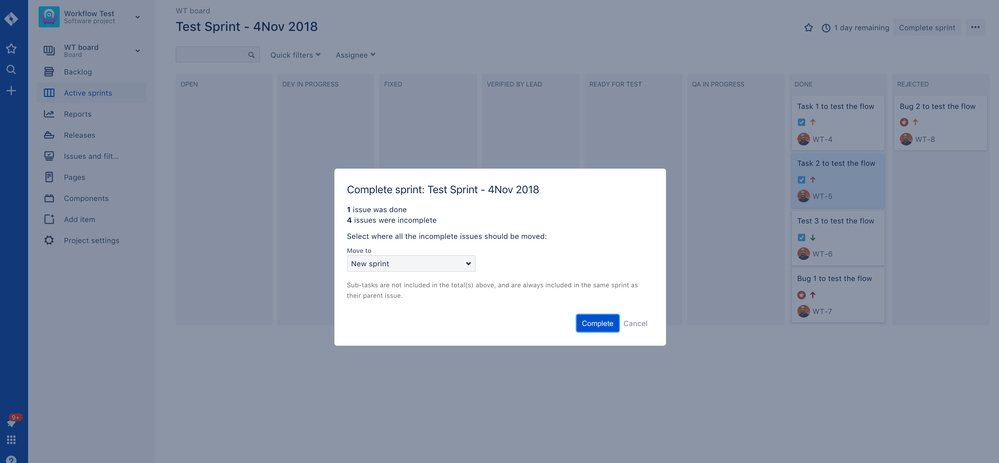

I am facing a problem , I have created a sprint and there were 5 tasks in it , am 3 were tasks and 2 were bugs .
What I did.
# Four tasks completed
#1 task rejected but in the sprint status it is showing only 1 task is completed.
# When I create new sprint the completed done tasks are moving in that sprint too.
Here is my flow screenshort and sprint details as well.
