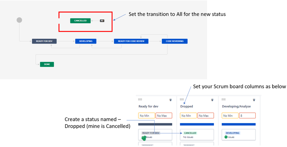

@[deleted] My suggestion is like the picture i have attached here.
Any status which is in Green means its a Done item.
an Organisation needs not have just one Done status, but there could be variants, so check with your Admin and try to create a status on the same accords, that is possible and it works.
Regarding the Rightmost column as mentioned by Jack in the Thread, It meant normally Jira or a flow based working approach recommends to have the final status items to the rightmost this is to ensure we have a good visualization of the activities and many teams follow this. (To-do, WIP, Done)
In the example which I have shown, the Cancelled status is the final (meaning its resolution = Resolved, or an equivalent to completed or answered, or Won't Do)
NOTE: the Cancelled Status should not be connected to another status, else there could be a chance where your engineers can do a by mistake move again, so here it means, an engineer can move an item from any given status to cancelled, but not the other way.

But then, concern is, if I create a column like in the image you have shown, cancelled status not being mapped to the last column, I cannot close the sprint. I have to have the cancelled status mapped to my last column to close the sprint.
Is there a way I can have cancelled/dropped as a separate column but not as the last column and still I can close the sprint ? Like  in the image ..Today if my board is configured like this, I cannot close the sprint .
