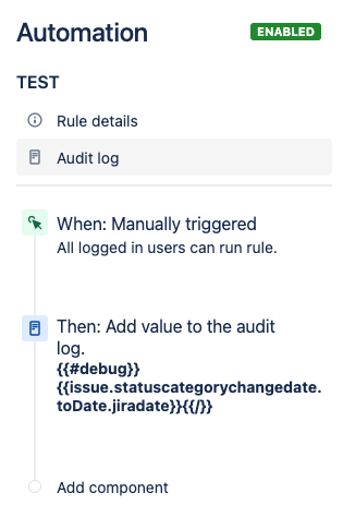

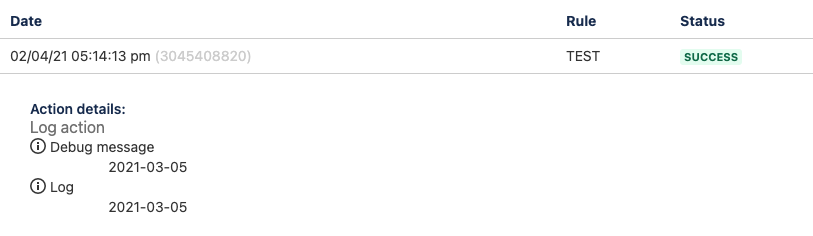

Why mess with REST API? Use Automation TEST Manually to verify.
Screen Shot 2021-04-02 at 5.17.18 PM.pngScreen Shot 2021-04-02 at 5.17.55 PM.png

Could you please elaborate? How can this automation fill in the field with the date the issue had been transitioned to "in progress" retrospectively (some tickets are already in another status)?
This line:
{{issue.statuscategorychangedate.toDate.jiradate}}
 only gives back the date of the last transition to whatever status and not specifically the date of "in progress" status.

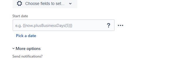

@John Funk's answer seems to be the one I am looking for, but there is a slight issue here that I cannot set a JQL query as a value for the 'Start date' field. Only a smart value or copy from another field's value.
So my plan was to set up a rule like this:
1. Scheduled trigger with a JQL query on all my tickets in the given project.
3. Set the value for 'Start date' based on a {{SMART VALUE}} where the smart value = the date the ticket has been transitioned to 'In Progress'
So my general problem is that I have zero clue what smart value could dig up the date of transition. But i guess it will look sthg like this:

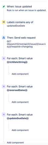

Heureka! Got it running!
So yeah, none of the Smart Values really turned out this helpful here but with a bit of magic help from our friends type-casting and regular expression there is nothing to be worried about! :D
As I mentioned in my first post, the API provides the information you need but using Smart Values only it becomes hard to access them. Once melted into a Smart Value Variable our JSON-like Smart Value {{webhookResponse.body}} turns into a sad little string - making iterations and so on quite painful experiences. I tried various different setups and came up with this solution (for some reason #if won't work in Smart Value list loops, so yeah - buckle up again...)
Once again setup the request action so it receives the data.
Then create a variable called "richDateString" with the following value:
{{#webhookResponse.body.changelog.histories}} {{created}}${{#items}}{{field.indexOf("status")}},{{toString.indexOf("In Progress")}}x{{/}}#{{/}}
This will produce a long string containing all timestamps the issue ever changes with as well as information on whether the field of the change was status and the toString was "In Progress" - again I wish the conditionals would have worked but well...
Once we know how the information we are looking for is represented (in this case its a "0,0" we append to the date info when both Strings (field and toString) matched), we are able to use regular expressions to match this pattern.
Since we want the first time it changed to "In Progress" we reverse the whole string and look for our pattern - again I tried a few other options but this just works.
So let's create a variable called "reversedDates" with the following value:
{{richDateString.reverse()}}
Now just create one last variable for the date, give it a name you like and set the value to:
{{reversedDates.match("0,0.*?\$(.*?) ").first.reverse()|reversedDates.match("0,0.*?\$(.*?) ").reverse()}}
And there you have it: A Smart Value containing the date when your Issue was first moved into "In Progress".
To be honest, this problem got me quite hooked as I felt it was wrong that this is not solvable - this is no go to solution but a bodge that works... It ain't beautiful but I still love it!
Hope this does it for you too, feel free to ask if you run into any problems setting up this rule :)
