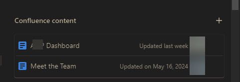

I am trying to create an automation for Jira, its mostly pretty basic.
I have a "template" jira issue that we are using.
My automation is:
Manually trigger
Then lookup issues > key=ABC-123
And create new Task
In the description box I have :
{{lookupIssues.description}}
This is working and pulling in the correct information.
However I have Confluence content links that I need to pull in as well. I can not figure out how to get this pulled in.
I have tried to set Confluence (Link) with a number of values and can not figure out what is the correct value. Currently I have {{lookupIssues.url}}
I have tried {{lookupIssues.contentlink}} and others. I have tried to plug them into the description field to see if I can get anything to pull in. I have been unsuccessful.
Any assistance would be appreciated.
