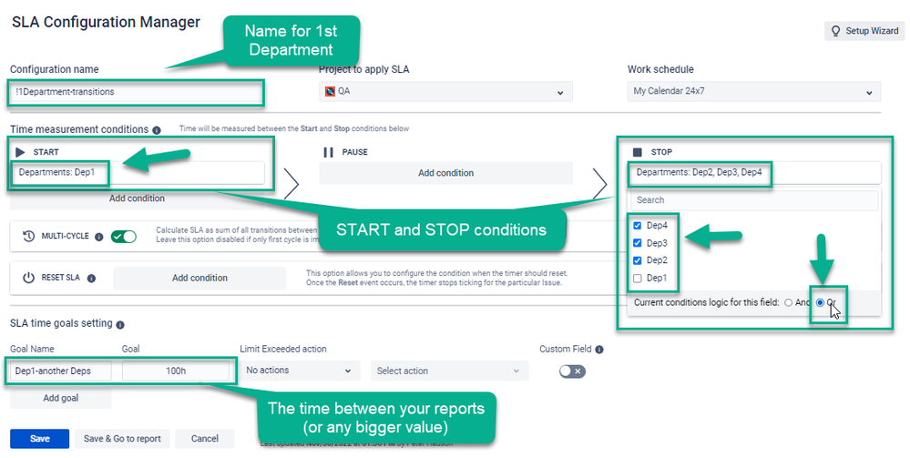

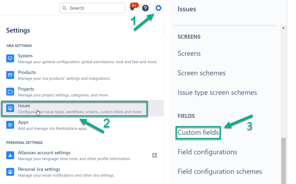

Hi @Kim White
Here is a good Use case of how you can organize SLA control for different Departments using Custom fields and the SLA Time and Report add-on (which my team developed).
I see your JSM tags, but you wrote that you use Data Center, so I warn you that the add-on works only for Jira Cloud and has a trial period of 30 days.
I hope you will find helpful information there.
