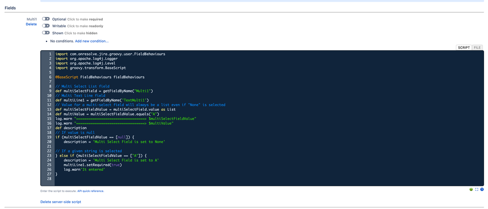

This is a sample script I tested on my end manage to work:
import com.onresolve.jira.groovy.user.FieldBehaviours
import org.apache.log4j.Logger
import org.apache.log4j.Level
import groovy.transform.BaseScript
@BaseScript FieldBehaviours fieldBehaviours
// Multi Select List field
def multiSelectField = getFieldByName("Multi1")
// Multi Text Line field
def multiLine1 = getFieldByName('TextMulti1')
// Value for a multi-select field will always be a list even if "None" is selected
def multiSelectFieldValue = multiSelectField.value as List
def multiValue = multiSelectFieldValue.equals("A")
log.warn "=================================> $multiSelectFieldValue"
log.warn "=================================> $multiValue"
def description
// If value is null
if (multiSelectFieldValue == [null]) {
description = 'Multi Select Field is set to None'
// If a given string is selected
} else if (multiSelectFieldValue == ["A"]) {
description = 'Multi Select Field is set to A'
multiLine1.setRequired(true)
log.warn'It entered'
Below is the screenshot:

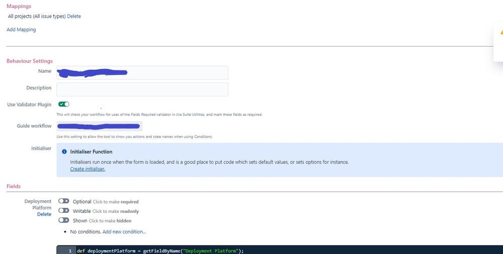

@Zachi Meyer Yes Add the deployment platform field to the behaviour? then add the script under the deployment platform field.
Can you please send a screenshot once you hide any sensitive info?
Best,
Fadoua
@Zachi Meyer Can you please switch off the use validator plugin?
Also I know my question will sound silly but did you make sure that both fields exist on the screen?
Best,
Fadoua

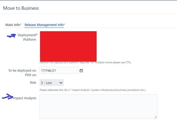

@Tinker Fadoua I switched off the validator but it still didn't work.
Both fields appears on the same screen (Please see the screenshot):
