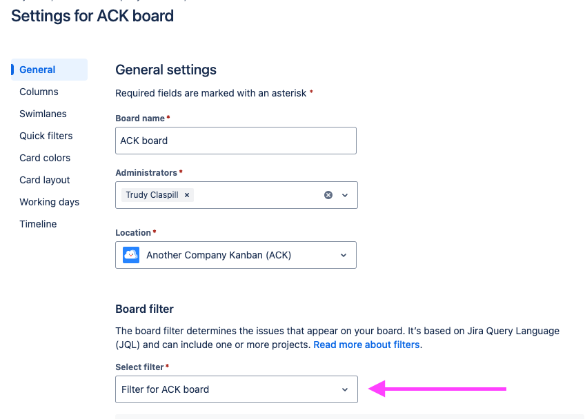

FYI - Another step after cloning each child issue would be changing the newly created child issue from the original Epic to the new Epic.
To display the issues in another board you would have to create a new filter to select those specific issues. You have to figure out the right JQL for that. For example:
issue in (comma separated list of new Epic issue keys) or
issue in (comma separated list of new child issue keys)
Another example:
parent=NewEpic1IssueKey or parent=NewEpic2IssueKey or parent=NewEpic3IssueKey or parent=NewEpic4IssueKey
...with the "parent=..." chain being one of those for each new Epic you created by cloning in order to get the child issues associated with that new Epic.
Then you would set the Kanban board to use that filter.
You could either copy the original Kanban board and change the new board to the new filter.

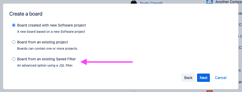

Or you could create a new Kanban board using the newly created filter as the source.
