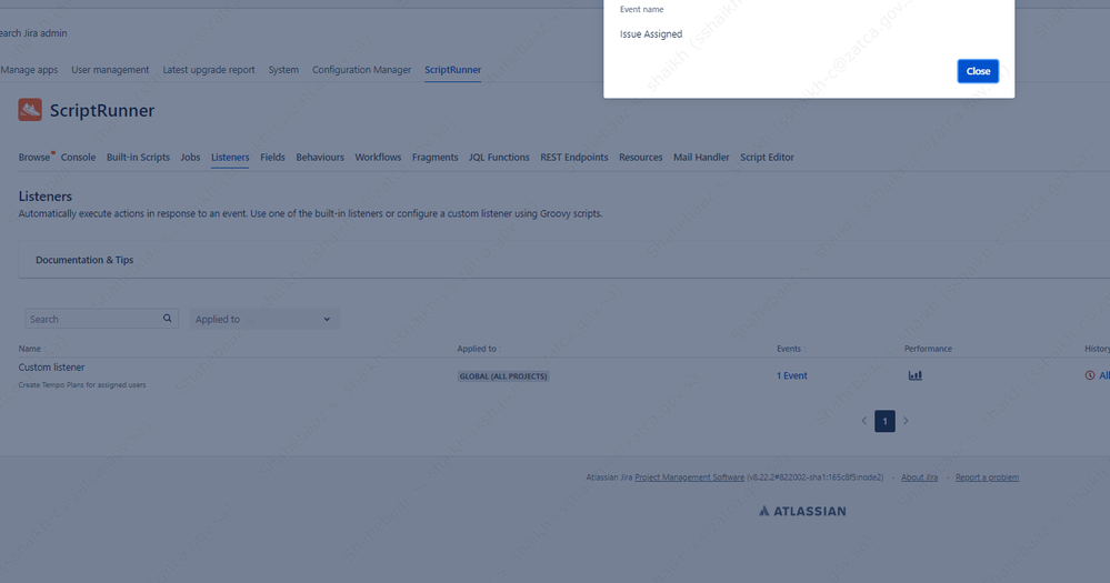

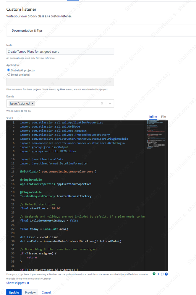

The listener appears to be complaining about the event. Could you please confirm which event you have configured for it?
It would be helpful if you could share a screenshot of the Listener configuration.
I am looking forward to your clarification.
Thank you and Kind regards,
Ram
baz89103
May 24, 2023
Thanks for the reply @Ram Kumar Aravindakshan _Adaptavist_

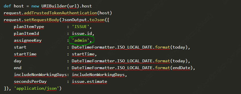

I have changed assigneekey to one of our admin account is this something i am doing correct or it should be the 'admin' itself. After the change error is different.

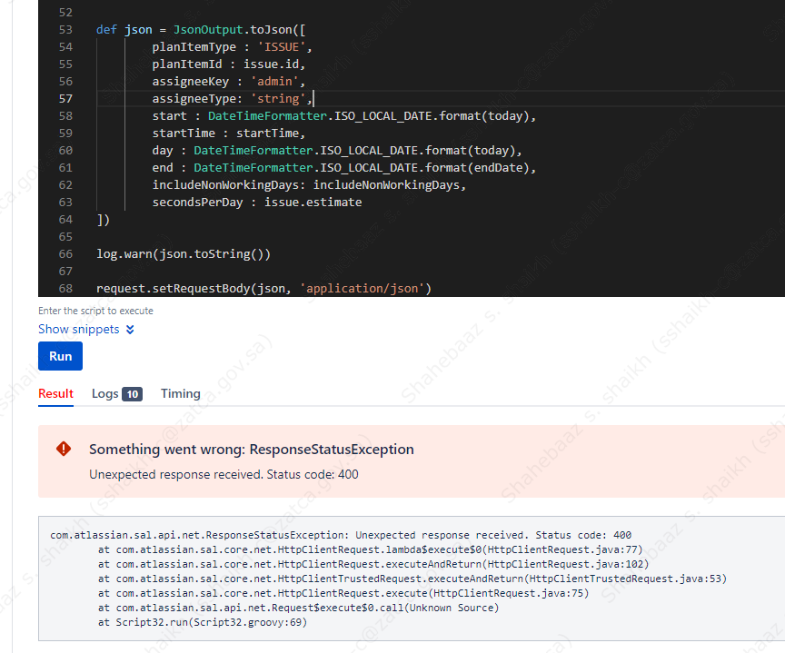

Well it's this part:
def url = applicationProperties.getBaseUrl(UrlMode.CANONICAL) + '/rest/tempo-planning/1/plan'
def request = trustedRequestFactory.createTrustedRequest(Request.MethodType.POST, url)
def host = new URIBuilder(url).host
request.addTrustedTokenAuthentication(host)
request.setRequestBody(JsonOutput.toJson([
planItemType : 'ISSUE',
planItemId : issue.id,
assigneeKey : 'admin',
start : DateTimeFormatter.ISO_LOCAL_DATE.format(today),
startTime : startTime,
day : DateTimeFormatter.ISO_LOCAL_DATE.format(today),
end : DateTimeFormatter.ISO_LOCAL_DATE.format(endDate),
includeNonWorkingDays: includeNonWorkingDays,
secondsPerDay : issue.estimate
]), 'application/json')
request.execute() // <---- this gives 400 Bad Request
So I made a few adjustments to fit this into script console so that I can test it:
import com.atlassian.jira.component.ComponentAccessor
import com.atlassian.sal.api.ApplicationProperties
import com.atlassian.sal.api.UrlMode
import com.atlassian.sal.api.net.Request
import com.atlassian.sal.api.net.TrustedRequestFactory
import com.onresolve.scriptrunner.runner.customisers.PluginModule
import groovy.json.JsonOutput
import groovyx.net.http.URIBuilder
import java.time.LocalDate
import java.time.format.DateTimeFormatter
@PluginModule
ApplicationProperties applicationProperties
@PluginModule
TrustedRequestFactory trustedRequestFactory
// Default start time
final startTime = '09:00'
// Weekends and holidays are not included by default. If a plan needs to be created on weekends and holidays, set this to "true"
final includeNonWorkingDays = false
final today = LocalDate.now()
//def issue = event.issue ; use a specific test issue in console
def issue = ComponentAccessor.getIssueManager().getIssueObject("SENDHELP-1")
def endDate = issue.dueDate?.toLocalDateTime()?.toLocalDate()
// Do nothing if the issue has been unassigned
if (!issue.assignee) {
    return
if (!(issue.estimate && endDate)) {
    log.error('Issue requires both an estimate and a due date. Plan not created')
    return
    BODY log to console so we can see what's in it
def json = JsonOutput.toJson([
log.warn(json.toString())
request.setRequestBody(json, 'application/json')
request.execute()
You can just change the issue key, everything else is fine, put it into console, run it, and then switch to Logs to see what's in the json before it's sent to the endpoint.
In my test case, I get:
{"planItemType":"ISSUE","planItemId":3086710,"assigneeKey":"admin","start":"2023-05-24","startTime":"09:00","day":"2023-05-24","end":"2023-05-25","includeNonWorkingDays":false,"secondsPerDay":28800}
Now, compare this with the documentation - https://www.tempo.io/server-api-documentation/planner#tag/Plan/operation/postPlan
What I see from this is:
  • assigneeType - required, but missing in json
Otherwise all other required fields are there, in right format.
Thus, I reckon you just need  to add this to the json:
JsonOutput.toJson([
assigneeType: 'string',
Which seems a little weird.. but that's according to what I see in the documentation. Probably this required parameter was added at some point, but the library contains old code.
Also, note I can't test it if it really does work - I don't have tempo, this is just coding on paper.

added the code to console, still getting the same error:

Radek Dostál
May 24, 2023
Hm, then perhaps it's with the TrustedRequestFactory.. Frankly, I don't have a good idea anymore.. If the data fits the documentation, the request is authenticated, sounds like a bug in that endpoint.
Have you checked if tempo logs anything to the logs when you make the request? Something that could hint to what it doesn't like.
Alternatively I would try to create a new HttpClient, provide base64 auth to it, and then read the response (maybe it says what it doesn't like), since we cannot see the response because it throws an exception with the request factory client.
The documentation also states:
HTTP: basicAuth
HTTP Authorization Scheme: basic
So it's entirely possible the vendor has implemented some dog$%&!ery which is unable to properly handle requests from trusted apps. Maybe it really does only work with basic auth.. Well we can test that:

Now, the idea with this is to test whether the problem is with TrustedRequestFactory (and the endpoint being dumb and not knowing how to handle it), and whether we can get it to work if we adhere to that "basicAuth" requirement they mention.
Either, this works, or it doesn't and we may see a message in response, rather than the exception which hides it.
Or, do also verify that tempo doesn't log anything in {jira_home}/log/atlassian-jira.log - maybe it contains a hint when the endpoint returns 400.
If this still doesn't work, I would probably open a ticket with Tempo so they can clarify / reproduce / explain what the issue is.

The script is working, Plans are getting created, However, looks like one issue with the logic. Plans are getting assigned each day for the total estimated hours ex: if i am setting original estimate as 2week it will create plan for 80hrs each day till the due date, if original estimate is 1week, it will create plans for 40hrs each day to the user.
Following script:

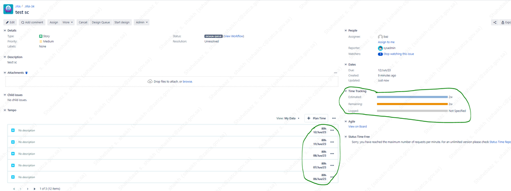

The script is creating the plans now, however, looks like there is one small logical error due to which Plans are getting assigned each day for the total estimated hours ex: if i am setting original estimate as 2week it will create plan for 80hrs each day till the due date, if original estimate is 1week, it will create plans for 40hrs each day to the user.

but I'm not familiar with tempo so I don't know how it works. Not sure what you want to configure there but I guess secondsPerDay param sounds the closest to what you describe?

@Radek Dostál  Yeah, I tried setting seconds per the day, however still it is assigning total estimations each day.
Thank You
