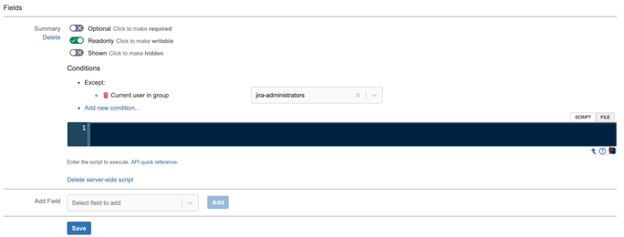

Check this:
In my example I used summary field but you can change it to Story Points.
I marked field as read only and set negative condition wich allows users from group jira-administrators to edit summary field.
I hope that this will help you :)
Regards,
Seba

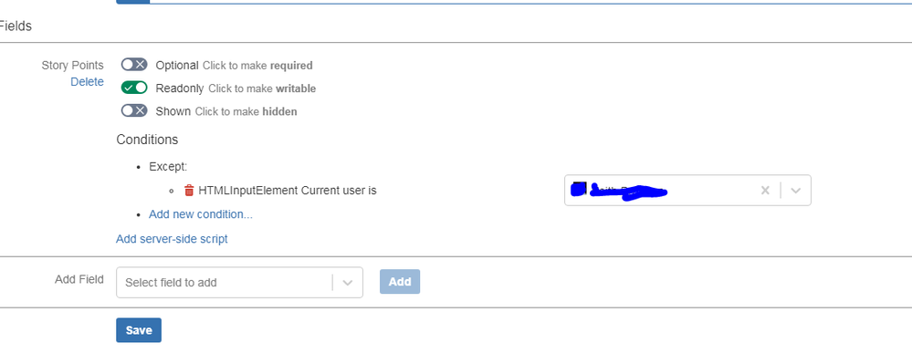

Hi @Sebastian Krzewiński , thanks for the response.
In this context what was your screen configuration? Does the field summary included in the edit screen? I think screen config. is overwriting the behavior setting.
This is my setting. What's happening is, it is read-only for all the users except the one I mentioned in the condition, only in the edit screen. Still inline editing is enabled for all the users.
October 3, 2019
Hi @Sarath
My configuration block summary field on edit screen.
Behaviours works only on create and edit screens so you can't achieve described action (block inline edit on view screen).
