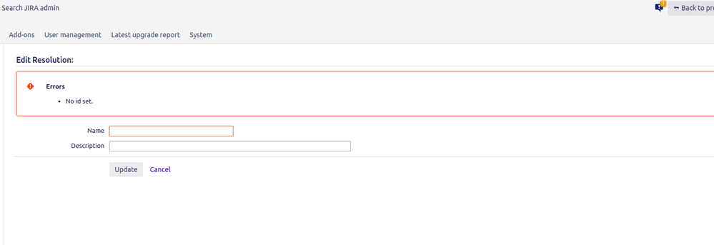

How can I restore deleted resolution , its Id is 10001. Thank youScreenshot from 2018-10-09 17_54_14.png

Actually, you can't.  You can add back the resolution with the same name, but it will take on a different id.  You should do that, and then update the functions that were using the old 10001 to use the new id.

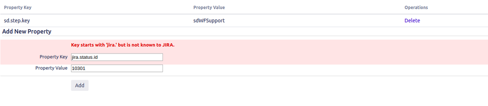

Hi Nic, I am on my way to update the functions that were using the old 10001 to new id but I am getting this error
 Key starts with 'jira.' but is not known to JIRA.
jira.status.id

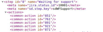

here is the xml of the workflow and the old Id to be replaced
and here is when I add another jira.status.id
trtg.pngplease help thanks

You're looking at unrelated things.
Properties on transitions and status are not related to the resolution id.  Additionally, you appear to be trying to set a status property, not a resolution one.

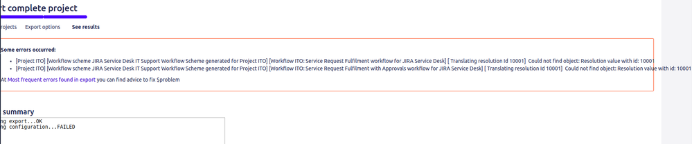

Hi @Nic Brough -Adaptavist- , the problem is I want to export my test project using your product which is the Project Configurator, and whenever I am exporting my project on test prod, it says that there is no Resolution Id 10001, I think we accidentally delete that so I came up with your solution to replace all old 10001 with the new Id that's why I'm doing that part.

Absolutely not.
You are mixing up status and resolution, and your "search and replace" could easily have damaged all sorts of things.
I think you should go back to the backup you took before doing any of this work.
Then describe what you are trying to do and why and we can guide you on how to do it the right way.

Hi @Nic Brough -Adaptavist- , here is the error on the project. I am trying to export this test project from test-prod and import it on prod to see if we can catch the following configs using scriptrunner: Listeners, Scripted Fields, Behaviors , and the JIRA configs : Screens, Custom Fields, Workflow. But this error is preventing us to export the projectScreenshot from 2018-10-11 09_52_00.png

Hi @Nic Brough -Adaptavist- , I already revert it back to original workflow, then edit the resolution value only, not all id with 10001, and it allows me to export the project. I only changed the values in the errors occured. Am I doing it right? Thank you

That's better, yes, the edit of the workflow has corrected whatever was trying to use the old resolution that you deleted.
