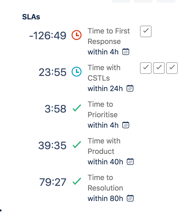

I'm struggling to understand how the following works:
GIVEN I reopen a previously closed ticket
WHEN the ticket reaches a status with an active SLA
THEN the SLA should restart or continue
 I have an SLA (Time with CSTLs) that does appear to restart every time it's restarted and ended - this is indicated by the ticks beside it.Screen Shot 2018-07-06 at 15.03.50.png

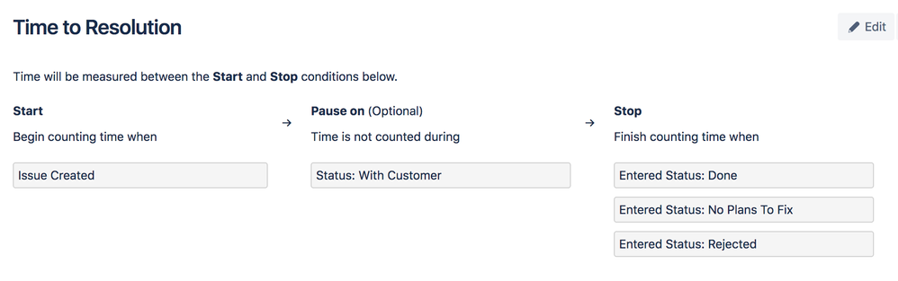

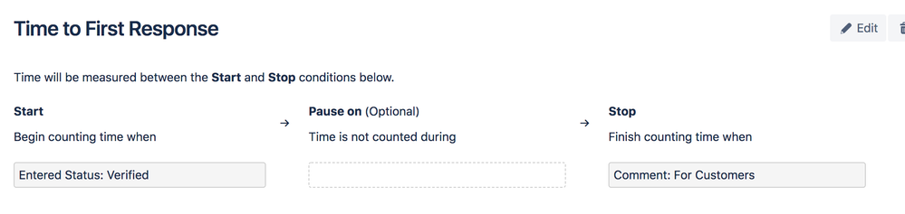

The issue I'm having is that the same behaviour isn't applied to the following SLAs:
  • Time to Prioritise
  • Time to Resolution
Please see below for the SLAs setup.
Screen Shot 2018-07-06 at 15.12.42.pngScreen Shot 2018-07-06 at 15.12.48.pngMany thanks for any help that can be offered.

I understand that the "Time to Resolution" and "Time to First Response" SLAs do not restart, is that right? There are a few causes to this behavior. I would advise you to check the post functions in the transitions related to the statuses that you use to trigger the SLA.
Gavin Johnson
July 10, 2018
Hi @Glauco,
Thanks for this! Issue was that I was setting clearing the resolution after the re-index had occurred.
