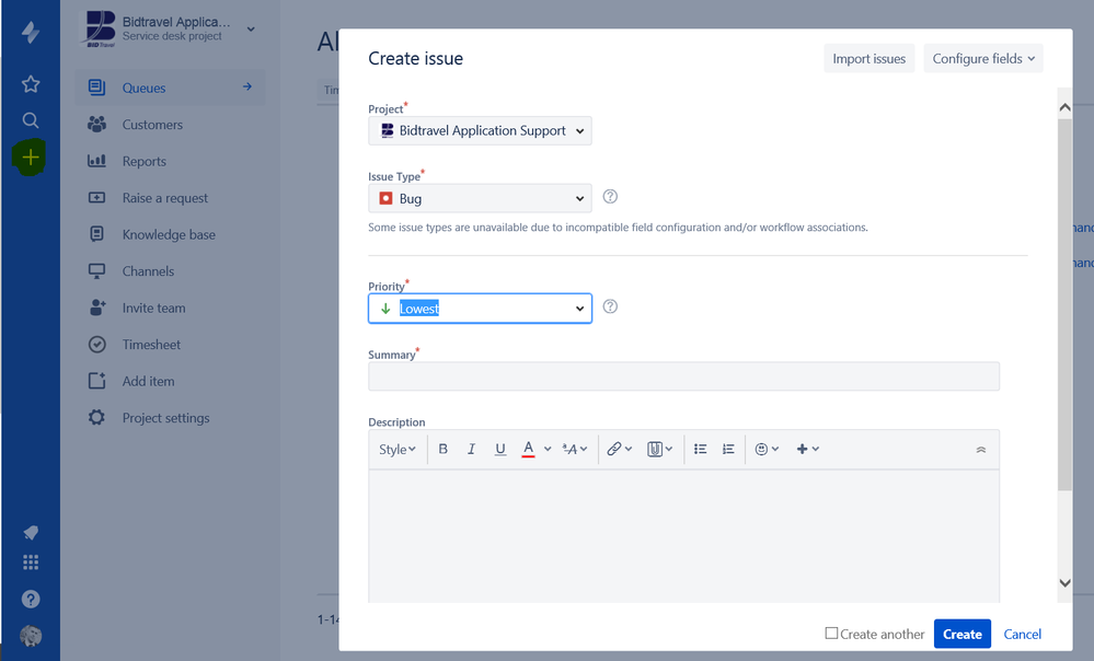

Hi Alexey,
I have attached two screenshots below.
When trying to log a call i use the plus below:

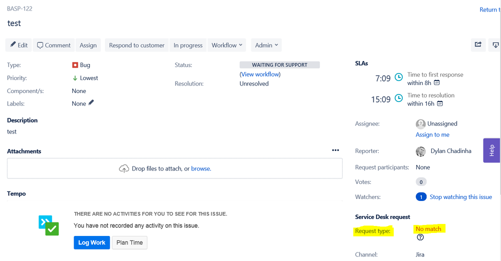

This is what shows once the call has been logged:

Ok. I now understand the problem. If you create an issue by the + sign, you choose the correct issue type (not request type), that is why you should manually set the request type.
When you use Jira Service Desk, you are supposed to create tickets either via protal or email. In the Jira interface Agents process issues, created by mail or portal. Agents are not supposed to create tickets in a Service Desk project. If you need your Agents to create tickets via Jira interface, then you should manually set the Request Type field.
