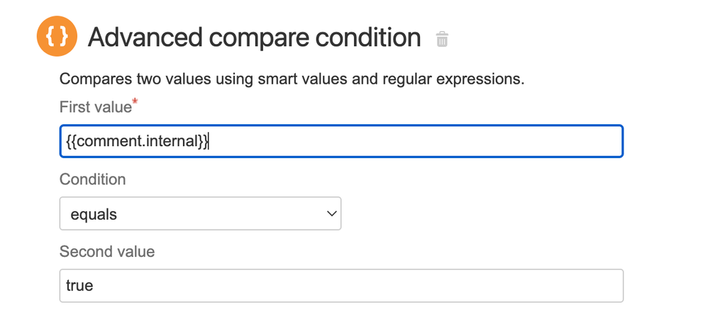

A quick note - on Server/DC 9.4.1 I just tested it with:
{{comment.internal}}
I had a simple rule with "when comment created" and I use advanced compare condition to match that to true or false and it worked correctly.
This was great - exactly what i needed. on my end, needed the "does not equal", but most importantly needed to know the path {{comment.internal}}. thx @Filipi Lima !
worked as expected.
