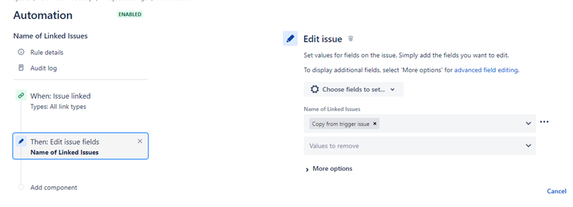

I've seen a few similar articles but they don't seem to fit my use case...I am trying to pull in the NAME(s) of linked issues into a custom field, Name of Linked Issue(s) (labels type), id = customfield_11600.
Is this possible? If so, I need the automation.
Help please!
Thank you!

Hi @Apryl Harris
What does "Name of a Linked Issue" mean to you?  Is this the Summary field?
And, would you please clarify what you are trying to accomplish?
For example, do you want to...
  • When an issue is linked to another issue
  • Copy the custom field "Name of Linked Issues" from one issue to another
If so, which is the "source" issue to copy from, and to which issue do you want to update?  The way your rule is written, it will do nothing other than copy the value from the trigger issue back to itself.
Or...do you mean something else?
Kind regards,
Bill

@Bill Sheboy - thanks for responding. My rule is wrong but I don't know how to correct it.

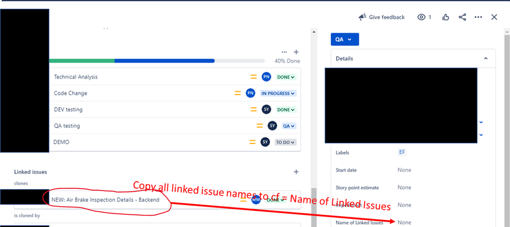

I'm trying to accomplish the below:
  • When an issue is linked to another issue,
  • Copy the linked issue's Summary to the custom field = "Name of Linked Issues" in the other issue
    • Name of Linked Issues is a labels type field.
      • For this to work, should the custom field be text?
  • then I plan use the filter results gadget on a Jira dashboard to list the stories with the Name of Linked Issues and the Linked Issues fields
Thanks for your help):
