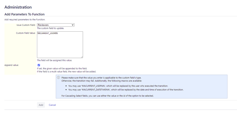

I want to automize my Workflow. These is one feature wich can help me with is but I can`t find approach with it:)
Its about collaboration of transition to status and post function at custom fields (CF).
I`ve created status "Reviewed" (transition from status "Code Review") and CF "Reviewers" (User Picker (multiple users)).
The main goal is autofilling this field with the name of user when he doing the transition.
Moreover, there is a special macros:
'%%CURRENT_USER%%'
But it doesn`t work.
Has someone the same issue or a way to fix this issue?
Screenshots:
https://prnt.sc/10obb6b
https://prnt.sc/10obcfn

Hi @Hlib Zhurakovskyi ,
welcome to the community. Try to setup %%CURRENT_USER%% and not '%%CURRENT_USER%%' (with single quotes) on the custom field value. This should fix your issue.
I just tested my solution in my dev environment and it works!
Please verify that you checked "Append value"

Oh, nice, it works.
Now what macro should i use to add current user instead replace?

The user that will perform the action will be added to that field.

Hi @Malik Waqas ,
happy that it helped! If you check append, user will be added to the list without removing previous users.
