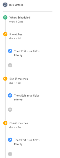

@Timothy Allen You can do this using Automation for Jira (built in to cloud).
Go to project settings > Automtion and create a rule with the following conditions:
This will run each day, and if the due dates fall within any of the given filters, then the priorities will change accordingly (you will need to select the priority on each of the actions on all branches of the rule)
