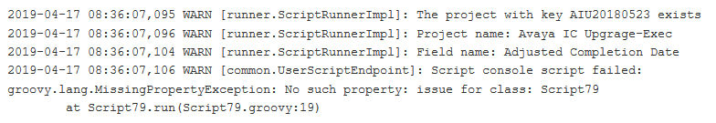

Thank you for the reply.  I am new to all of this, so I am not quite following along.  I am using this Profields field at the project level, so I do not actually have an issue to look up.  As a result, when adding "def value" as indicated, I receive the following:
You mention that I can get the value directly from the Profields field.  What would the code be for doing this for the specific project for which I have established context based on the given projectKey?
