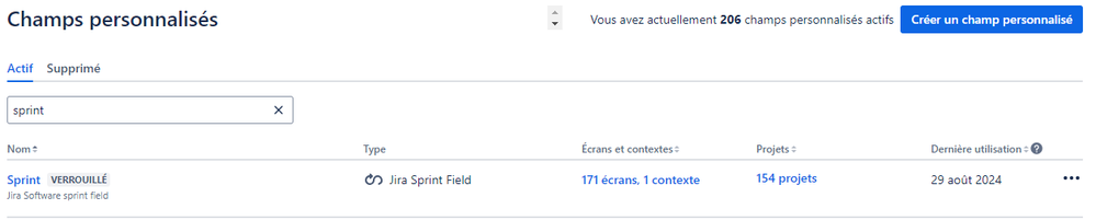

And when I search in the custom field, I only have one Sprint field locked

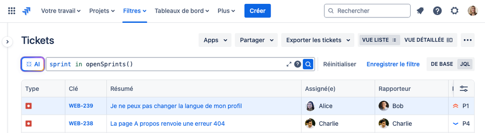

The screenshot shows that you're typing Sprint in Sprintactif() instead of the correct JQL function:
sprint in openSprints()
Even if your profile language is set to French, you need to type JQL functions as written in the documentation.
Hope this helps!
- Manon

Hello,
Unfortunately, I only see the one custom fields Sprint (on the second screenshot)
I already test with this JQL but I cannot understand why overnight the first request stop working
No new custom field with Sprint in the name was created

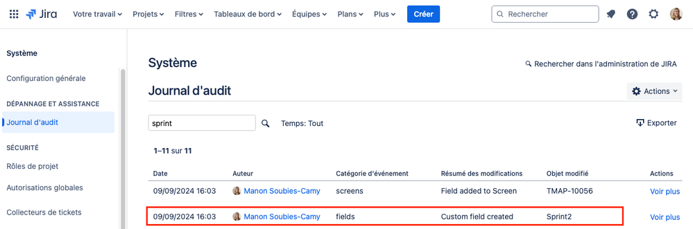

I created a new dropdown field that I named "Sprint2" in a team-managed project, and it does not show up in the global Custom fields menu. I do see it in the global audit log though:
Could that be the issue?

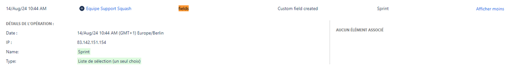

Unfortunately, no one remember creating it..
And don't know where I can run this request to find the custom field created
You can run it in the issue search, where you ran the "Sprint in openSprints()" one. It will only work if users filled out this field, though - if no one uses the new Sprint field, it won't return anything.

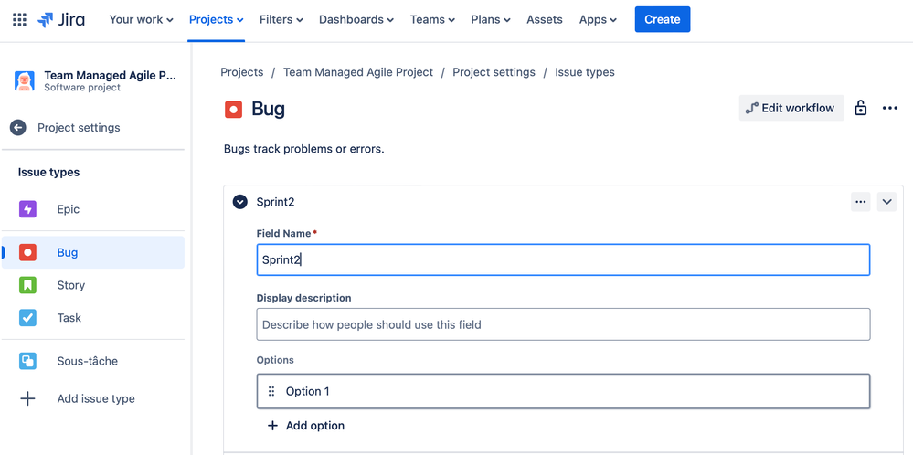

Sure, you can rename the custom field from the team-managed project's admin menu:
Hope this helps!
