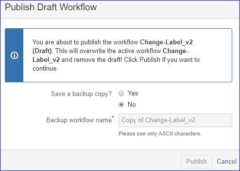

Hi Support,
when i modify a Workflow JIRA, after tipying PUBLISH the pop-up still in progress without loading wheel (disappear after 1 or 2 seconds).
See print in attachment, could you help me ?
The way to have effective Publish is to Close the page and relogin it.Publish_NOT_WORK.JPG

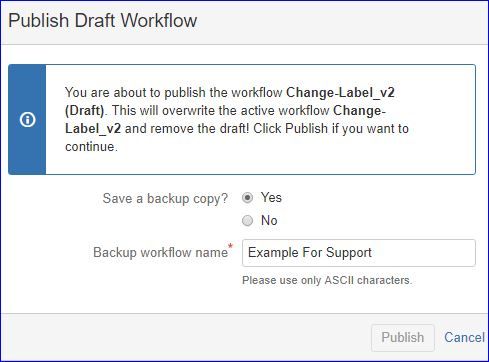

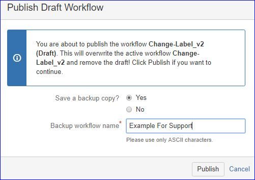

Paolo Palermo
October 24, 2017
Ciao Bashir,
sorry probably i've not explain better.
I replay the problem step by step
  1. Modify Active Workflow
  2. Click on Publish
  3. The Pop-Up is opened and ask me if i want a backup.
  4. Indipendent by Choose, example YES and write a name, click on Publish
  5. For just one second i see the loading wheel
  6. The page is blocked on pop-up.
I don't have other option except to close the page.
This problem is born about 2 week ago, please could you help me? If you want, i can share my desktop.Step_Publish.JPGAfter_Tapy_Publish.JPG
