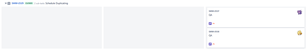

Darrin Mealio April 1, 2023
Yes. They are "closed". I have attached a screenshot from our current sprint as an example. This ticket (SMW-2529) was closed 2 sprints prior, it was not "showing" in our previous sprint.

I think you will find that someone remapped the status of the old issues in the board config, or changed the board filter.

Take a good look at the current and previous status of the issues in the history.  It will not show you how people have remapped the board, but it will tell you what status changes there were.
