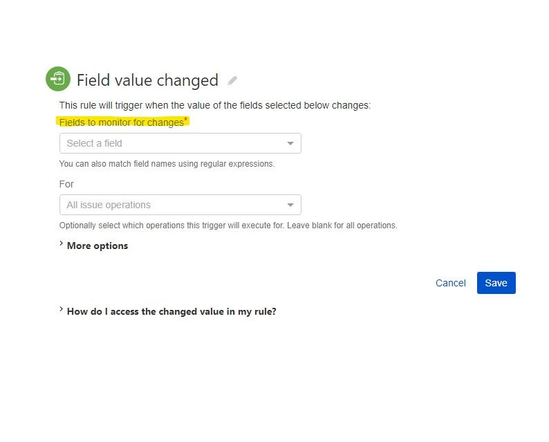

I have a Insight field which I am trying to use in an automation rule. When I create a trigger and try to choose the field, it simply does not appear in the dropdown. When I try to chose that same field in my actions I am able to pick the field out of the dropdown list.
Am I missing something?

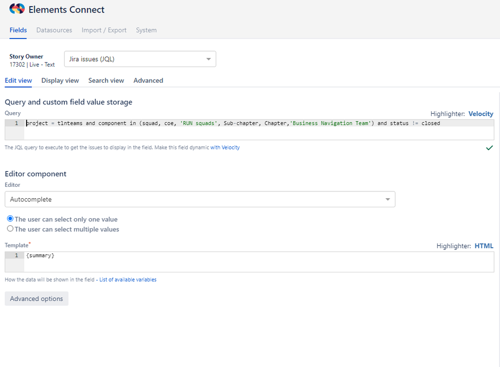

Awesome! I found the solution:
and it looks something like:
"fields": {
"customfield_17302":"{{triggerIssue.fields.customfield_17302}}"
Works like a charm. Thank you for the big push in the right direction Christophe!

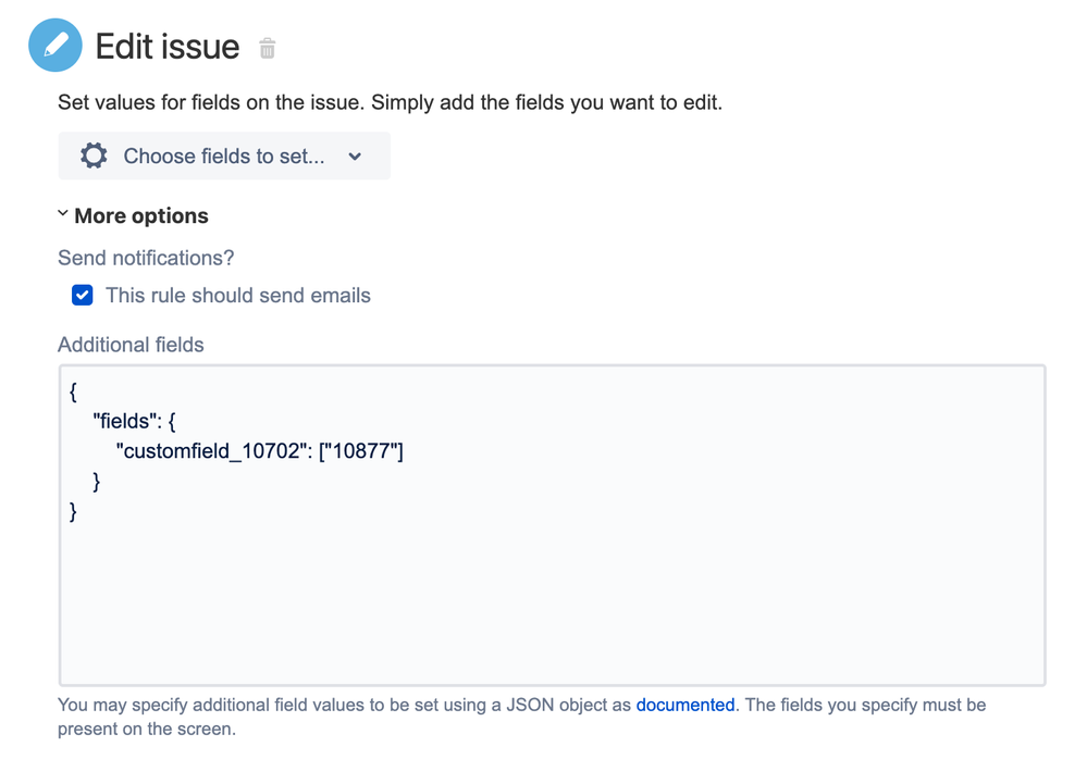

The workaround is to manually set the field value in the "More options" > "Additional fields" textarea.
Here is an example:
In this example I set the value of the Elements Connect field with ID 10702.
Please note that you must set the field value (its called "Key" in Elements Connect) and not the field display value.

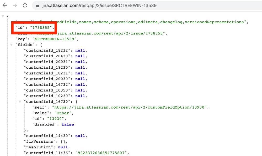

To get the ID of an issue, you have two options:
  • Call from your browser https://<jirabaseurl>/rest/api/2/issue/<ISSUE KEY>
    The Issue ID will be in the JSON document returned

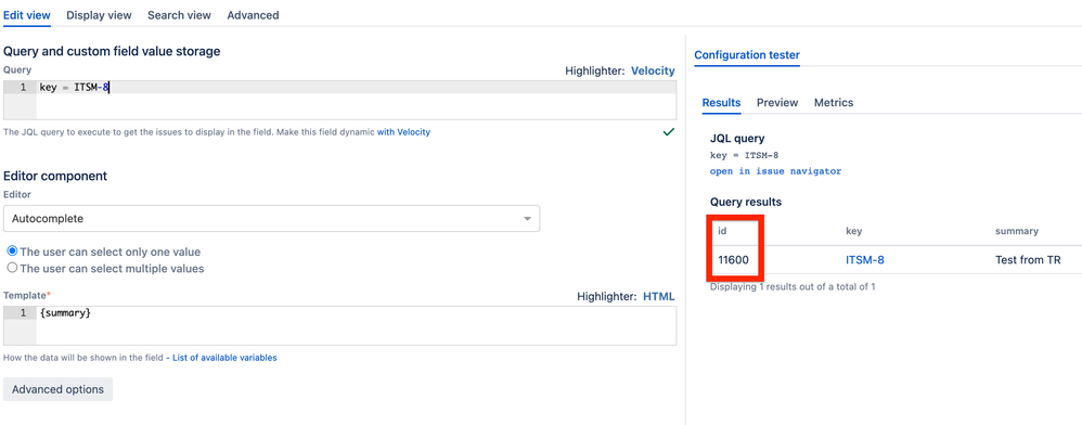

  • From Elements Connect field configuration, execute the "Configuration test" by clicking on the "Run test" button, the issue ID will be in the "Result" tab (you can adapt the field query to retrieve a specific issue like I did in the screenshot below)

We encounter the same issue. We use Automation for Jira and we need to trigger an automation rule when the value of an issue's field (Insight field) changes.
Unfortunately, Insight custom fields do not show up within the "Fields to monitor for changes" dropdown list. Thus, we are not able to trigger an automation rule when the value of an Insight field changes.
Is there any news when this feature would be implemented? Or is there any workaround?
