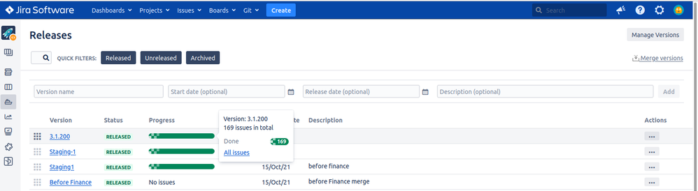

You can see there are 162 issues in "Done" column, and they are still visible.
And here is the screenshot from the releases - version 3.1.200, where are all these issues, still visible on our Kanban board.
All issues has the value 3.1.200 in the Fix Version field.
Any ideas what is the reason for this?

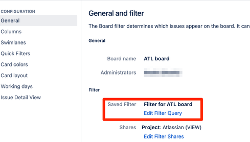

Hi @Assen Natchev , welcome to the Community!
Would you be able to share the current JQL filter for the board? You can access it from the board's settings. Click the Board dropdown in the top-right, then click Configure:
On the General tab, there is a Filter section:
We would be interested in seeing the JQL filter saved for this board. It's likely that the JQL needs to be updated to exclude the issues from the version that was released already.

Assen Natchev
December 20, 2021
Hi Daniel, thanks for the quick reaction.
I followed the path for the board filter you gave, and there is no any visible filter. Here is the screenshot:
