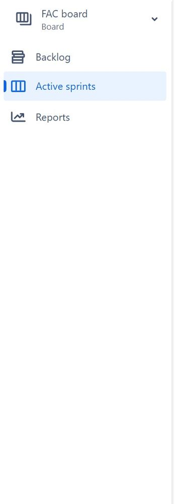

Srikant_Vijayendran
July 18, 2024
Please help - I create Company Managed Project and now I am not able to see anything on the board - such as timeline, and all.
Please guide
