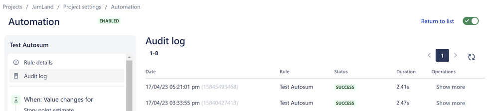

I need some support since I configured an automation rule for doing an autosum of the estimations of the subtasks in the parent task.
The event is triggered on the creation or edit of subtasks tickets, and it is supposed to be running correctly with status sucess for every edit but the sum is not executed neither reflected on the parent task>
Sucessful status with no updates on my ticket

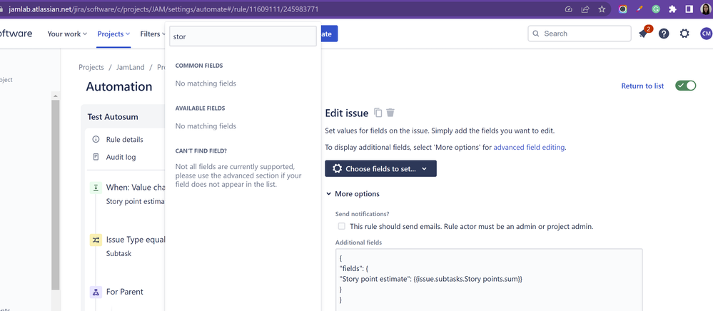

My current automation rule

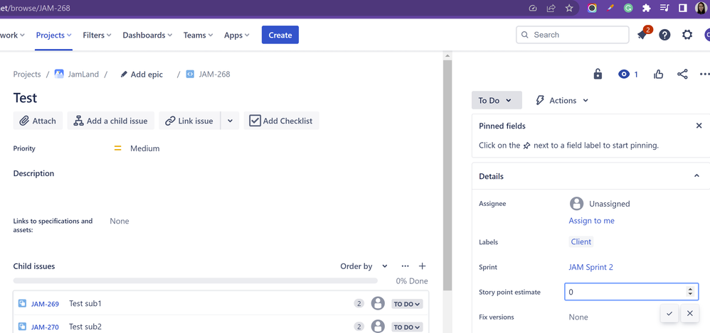

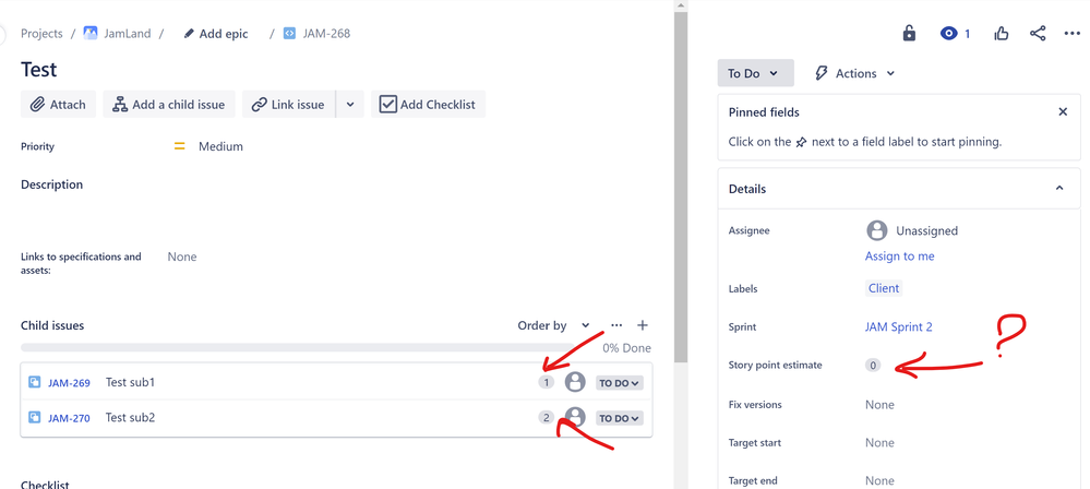

The parent task that is supposed to be updated with the sum of the subtasks estimations:

Hello @Criselda Mora
I believe your problem is in the code that you have used:
"Story point estimate": {{issue.subtasks.Story Points.sum}}
It needs to be:
"Story point estimate": {{issue.subtasks.Story point estimate.sum}}
Criselda Mora
April 19, 2023
It was this!! Thanks a lot @Trudy P Claspill

Hi Callum, I'm cleaning my other rules to check no other automation is interfering, but for the par of the advanced field I think I need it because the field is not appearing in this search even when it exists
