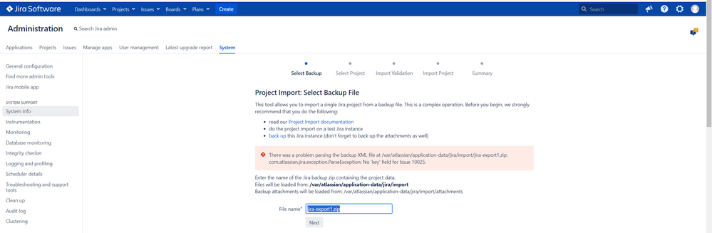

3. I tried project import but I was getting an error no 'Key' for 10025

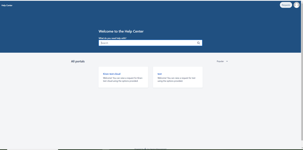

4. so then I tried to install data center on different machine, while setup after DB details, I tried importing existing data ( I copied the backup on data center server at /var/atlassian/application-data/jira/import then  once the importing is done.
it's taking me to help center page but it shows my projects from cloud but I am unable to do anything with those projects.
5. what credentials I use to login (i didn't setup any credentials). sysadmin/sysadmin works but I can't create any users or projects etc...

Hello @Michel Neeser  I followed that guide, once I login using sysadmin, there is no option to change the password.

@kiran pamulaparthy As already mentioned by @Robert Wen_Cprime_, this is the help center of Jira Service Management. If you want to migrate Jira Software, you need to change your binary as described in the guide I provided above.

I tried with binary file: atlassian-jira-software-9.12.0-x64.bin but I still get the same error. Am I doing anything wrong here?jira-software.PNG
Michel Neeser
December 7, 2023
@kiran pamulaparthy Please check out this post, maybe this helps with the error you're getting.
kiran pamulaparthy
December 7, 2023
@Michel Neeser  I tried that but didn't help.

So, what type of projects are you migrating from Cloud to Data Center?  It looks like the binary you have is for Jira Service Management(JSM).
