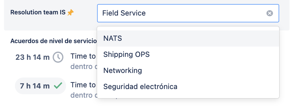

A new field has been created in our Jira, called: resolution groups, how can I massively populate it for previously opened tickets?
We need to assign these fields to tickets that are already closed.
