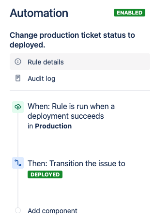

Salvatore Testa
May 4, 2021
I used the Jira Automation plugin (https://www.atlassian.com/software/jira/features/automation) and set up this rule to get this behavior.

Salvatore Testa
January 14, 2021
I'm having the same issue!
When you move an issue to Done you want it to do an automatic Release. Correct?
If I'm reading Claudia's question right, this summary isn't quite right.
If I'm fixing a bug Jira ticket, when the code has merged, Bitbucket moves the linked ticket to "Done". The next step should be, when the linked commit makes it to production (e.g. using the "production" deployment tag on Bitbucket Pipelines), I would like for Jira to move the ticket to "Released" or some other status to show the code change has been deployed to servers.
Does Jira have some way of triggering a status change ("Released" in my example) when a ticket is in the production deployment?
Like Lucy Dilts likes this
Lucy Dilts
May 4, 2021
Hi Sal - I am trying to figure out how to do the same thing. Any luck?
Salvatore Testa
May 4, 2021
@Lucy Dilts, yes! I just made it an answer on the post so it's less buried.
