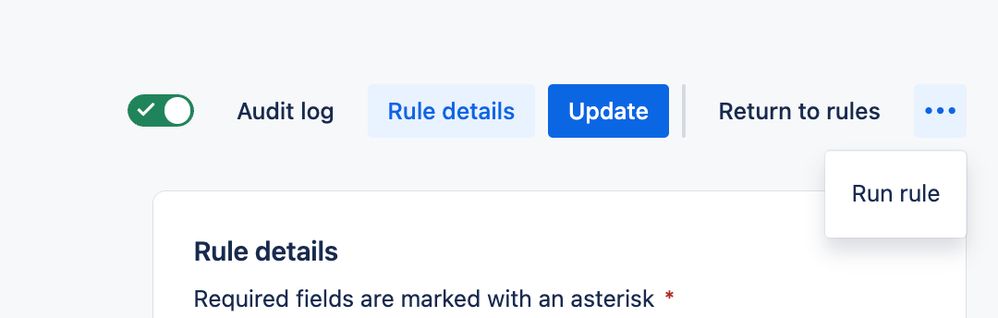

I'm not sure when they added this functionality, but you can run the rule, by clicking the 3 dots, to the right of "Return to Rules" and select Run Rule

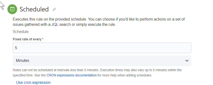

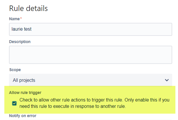

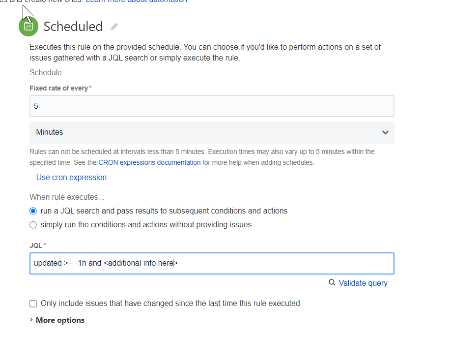

Hi @Ray Letoa ~ that additional information helps!  😀  Use the Scheduled trigger combined with a JQL that searches for issues updated <= -1h.  There is also an option to allow other rule actions to trigger your rule (as shown in the second screenshot below).  HTH

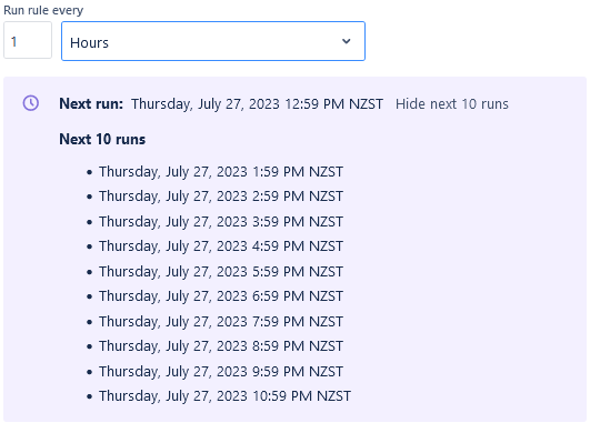

@Laurie Sciuttiyou absolute star - the issue Im running into now is that I have two tickets created at different times one created at 1:30pm and another at 1:45pm, Ideally the ticket created at 1:30pm would repeat at 2:30pm and the same with the ticket created at 1:45pm to then clone/repeat at 2:45pm.
What Im finding is that the rule is executed at one hour intervals from when run and clones all tickets simultaneously rather than at staggered intervals
Do you know of any way around this ?
thanks in advance

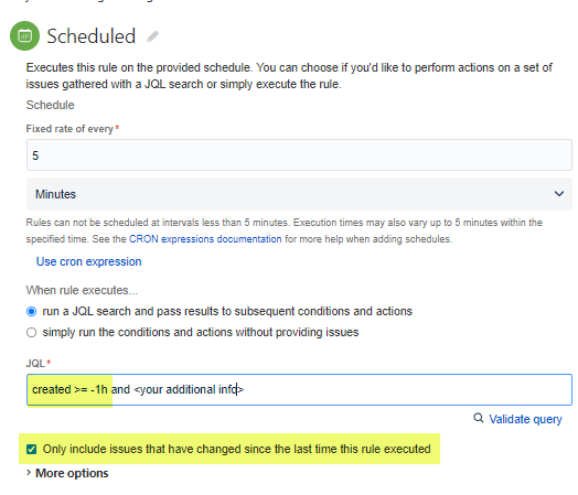

Hi @Ray Letoa ~ then use the created >= -1h in your JQL and ensure the "Only include" checkbox is checked.  If that still doesn't work for you then you can probably create a dummy datetime field that you set through an automation rule to equal create date + one hour that you can then use as a trigger in another automation rule that creates your additional issue.  This seems less than ideal though.
Can you provide the full details of what you're trying to do?  Like what additional conditions need to be met to automatically create new issues after one hour?
I did find some additional community posts similar to what your are asking that might help as well.
