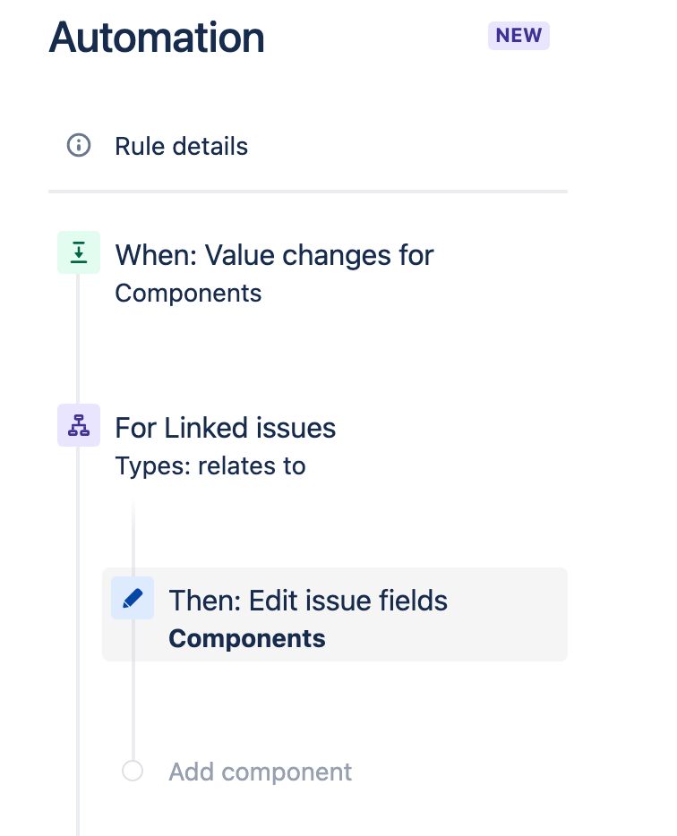

Thank you for clarifying that you use hosting. As @Craig Nodwell mentioned, you can use an automation rule to achieve this functionality. I've included a screenshot below of what an example configuration would look like.
Simply put, I'd choose the following:

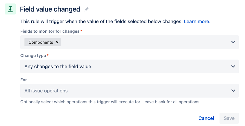

Trigger: Field Value Changed - select the field that you want to monitor for changes:

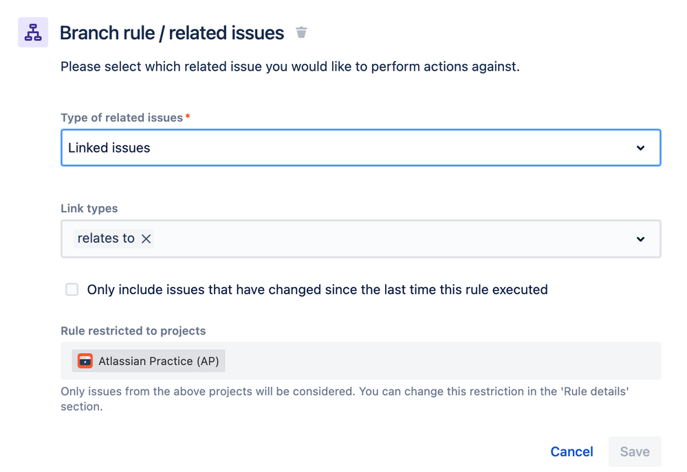

Then, choose "Branch Rule/Related Issues" so you can comb through any linked issues to apply the automation rule to. You can choose which link types to search against for your automation rule:

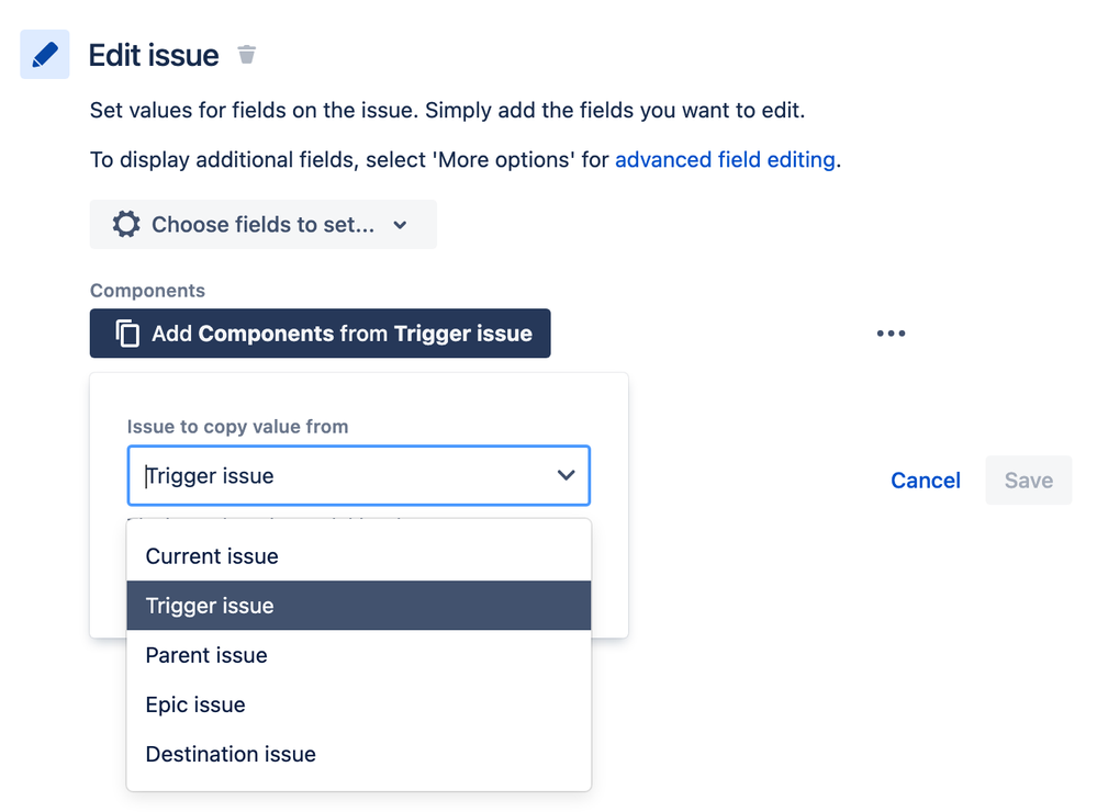

Then, choose the "Edit Issue" action, choose the field that you want to update, then select "Trigger Issue" which will copy the value from the issue that triggered the automation rule and apply it to the linked issues for the particular field.

I'm struggling to make this work with tickets from different projects. We can make it work between tickets in same project but want it to work for tickets that are linked but in different projects.
Any suggestions? :)
Is your rule restricted to just one project or does it cover multiple projects? To check this, you can go to the rule details.
