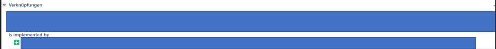

I actually need all Issues which have the below (see picture) link to the destination in the following format:
linktype to destination, destinations issue key, fix version, "request type"
