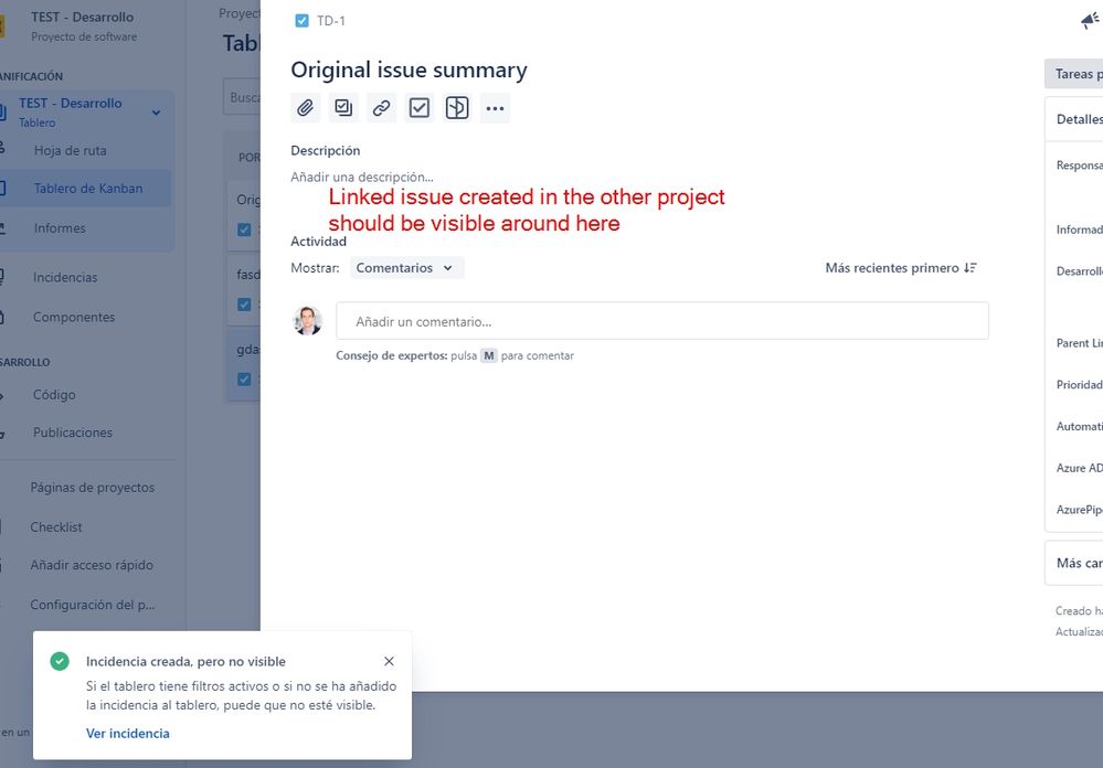

TD > TINF
Linked issues don’t show neither in PS nor in PW
Immediately after operation the pop-up in the bottom left corner appears:
Issue created, but not visible
If the board has active filters or if it has not been added
the issue to the dashboard, it may not be visible.
See incident

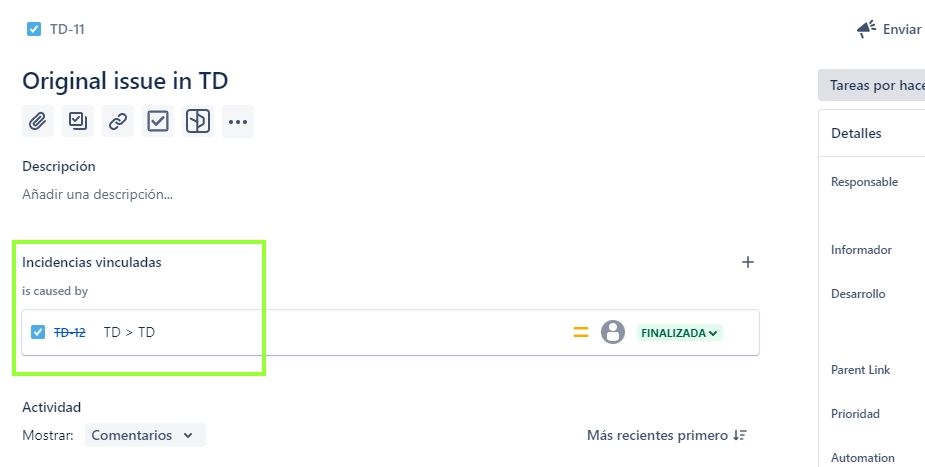

TD > TD
Everything fine, as expected:

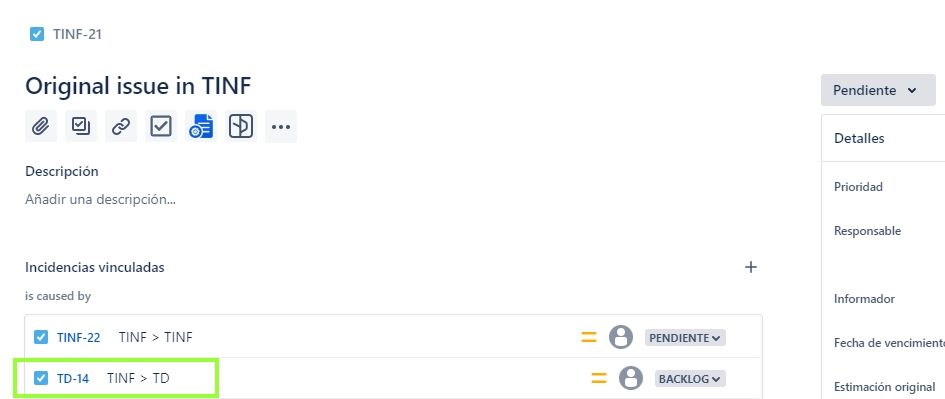

TINF > TD
OK
TINF > TINF
OK (see image above)

Manuel Carmona
March 13, 2023
Hi there.
I opened a ticket directly to Atlassian and got the following answer which I guess puts and end to the matter:
The option to directly create linked issues is not available for Jira Software projects at this moment, although it was already implemented for Jira Work Management and Jira Service management. However, we have a feature request for the same that can be tracked below
JRACLOUD-74100:As a Software user, I'd like to be able to create new linked issues as it is possible for Business and Service Desk projects issues
