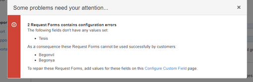

hi,

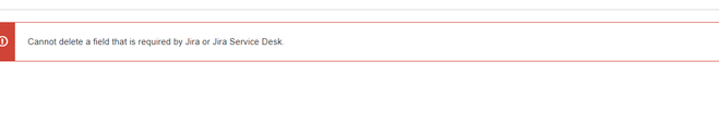

i was making improvement on service desk, i wrongly deleted required custom field and now, im making changing on service desk --->projects------>Helpdesk------>request type----->Edit Fields
i see this error right on the page!!!!
Please help,
Thank you...

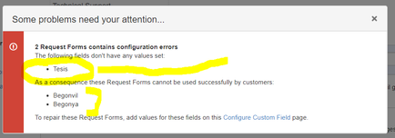

Capture.PNG                                               i deleted "Tesis" from custom field
so i cant see reference (Begonvil,Begonya) from inside it.
When i created new "Tesis" custom field  and inside references(Begonvil,Begonya) still continue to see this error
How can i follow steps?

JIRA uses field IDs, not names. When you created the field again it is a different ID than the one you were originally pointing at.

First backup JIRA so you can go back if there is a problem. ALWAYS backup any tool like JIRA before making destructive changes.
Go into the forms listed in the message and delete the reference to the field and then add it back in. That should pickup the newly created field.
