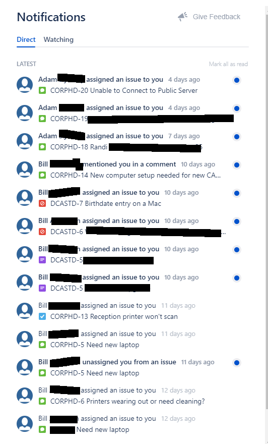

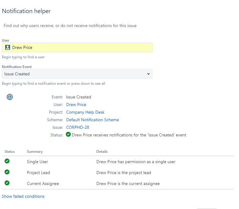

I have checked all of my settings and Notification Helper, but despite all of this I am still not getting notifications upon issue creation, Any tips on how to start troubleshooting this? NotificationHelper.PNGNotificationLog.PNG

Another way to handle this is to create an Automation Rule. Within the project, go to Settings - you should then see the dark blue navigation bar on the left. look for "Automation". Click on that. In the upper right, click "Add Rule". choose "Custom Rule" at the top. Click Continue. "When this happens..." choose "Issue Created" click Add. Then under "Then do this..." click "Alert User" and type your name. Then click Save. You would then probably want to add a new queue in the project just for these so you can keep track of them - Something like "All open issues" Note you will only be notified for issues created within this particular project not all projects. Hope this helps.

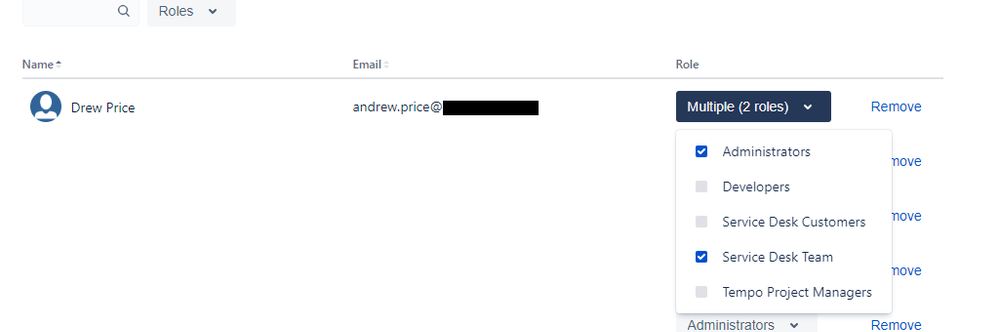

If I go to people under the project I can see that I am a member of Administrators and Service Desk Team. This is what I see when I go to Settings > People. Settings-People.PNG
We do have a license.

In your JIRA, Look into your notification scheme. Edit the scheme and add yourself as a single user. That should fix it.

I did some more testing, and when another agent creates an issue I will get the notification, but not when the issue is created through the customer portal. Here is a screenshot from the latest test.
NotificationHelper-2.PNGThanks for all your help so far.

Not yet, the main issue still persists, when an issue is created from the portal I do not get a notification. This seems really absurd to me since the notification helper seems to confirm that I should be getting notifications at least 3 ways.
