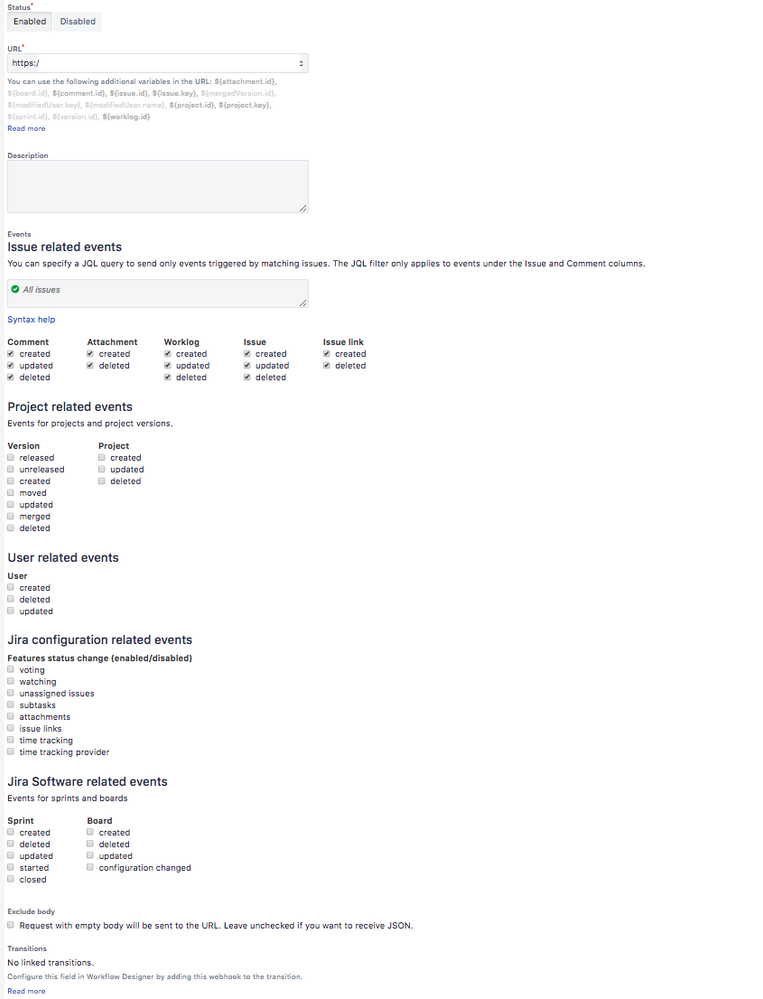

Hi, I am trying to setup webhooks to that my azure functions are executed. At the moment I do not care what the event is, I just want the webhook to fire. For this reason I have checked all the events. I have posted a screenshot of the setup in the webhook. We are using the Cloud version of Jira so I am not sure how to debug. I have tried to create an issue, delete, add worklog etc but nothing seems to fire the webhook because there is no activity in the Azure function.
I have tested to paste the URL in the browser and I get a response and the azure function is triggered.
Is there a way to see a log or something similar?

I have tried to do a GET request through postman with the url that I entered in the webhook setup.
That works fine.

I have also tried with a POST which works fine from postman. I have followed the guide in the second link you posted. What I did skip is the part about:
"Add a webhook as a post function to a workflow", from my understanding this is not necessary.
What is weird for me is that the azure function is not logging any activity at all about incoming requests when I try to create a new issue for an exisiting project, add logging for time (worklog) or make a comment.

I found a solution that i posted as a new answer. Thanks for the help though. If the problem is because of long URLs in Jira maybe this is something that should be mentioned or fixed?
