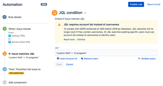

If I'm correct, you can use the plugin Automation for JIRA to achieve this functionality, however, there are two things required to make it work:
1 - Since the automation will run across projects, please create the rule using the global administration option.
2 - Since there are no trigger options for clone or copy issues to other projects, you would need to clone and them bulk move the issues to another project to trigger the automation.
Here's the rule:
The background details of the rule:
- The move from the project will trigger the automation
- Will run the SQL query to confirm which value is selected to the custom field
- The issue will be transitioned
Let me know if it works for you.

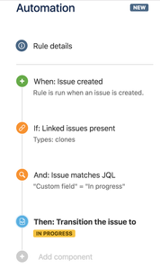

Hello Tomasz,
I have investigated a little bit further on your request and I found out a new way to configure your automation, which would not require you to clone and them move your issues, but to clone it directly in the project you want.
This would be the rule:
