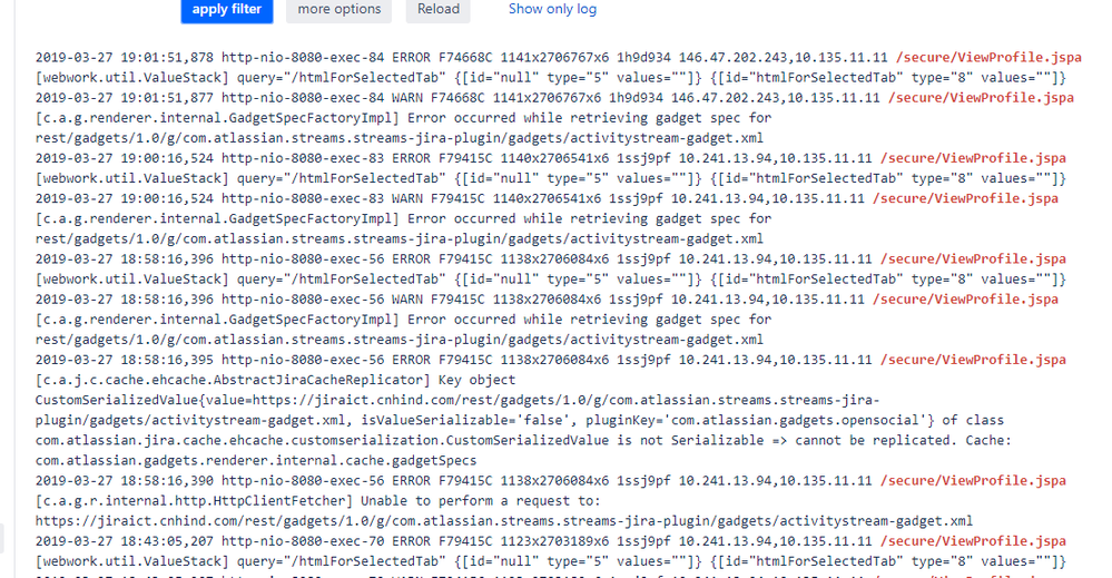

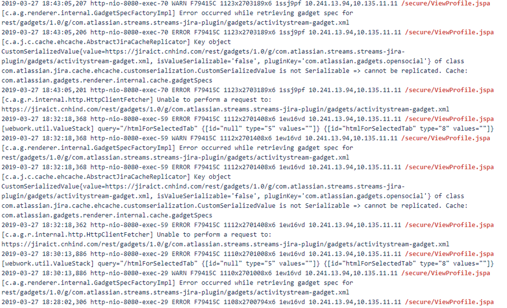

Is there anything in the log you can share with us?
You can copy and paste the most recent entires from /var/atlassian/application-data/jira-home/log/atlassian-jira.log
Look for entires which hint at user profiles such as:
/secure/ViewProfile.jspa
Thanks @Zachary Hayes , I do not have server access right now but i have installed View last log add-on and i can see all the logs let me send you, Those pictures.

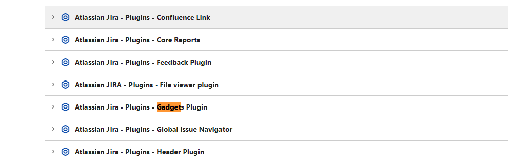

Thanks @mittapalli m Do you have an add-on called Gadgets Plugin or something similar?
https://confluence.atlassian.com/jirakb/missing-gadget-error-occurred-while-retrieving-gadget-spec-for-rest-gadgets-1-0-g-com-atlassian-jira-gadgets-394464394.html

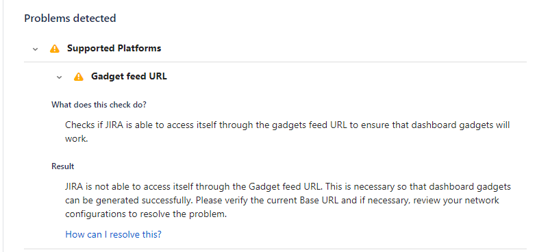

I think i have that plugin, and if the issue is with the plug-in, I am getting one error in Instance Health.Please check it below.
@mittapalli m Can you check if your Base URL is the same as the URL you're accessing your application with? If not, change it so they match.
How to configure Base URL
https://confluence.atlassian.com/adminjiraserver073/configuring-the-base-url-861253968.html
@mittapalli m Documentation on a failed Gadget feed URL health check suggest it's either a problem accessing the URL or a problem with the server. One thing you could check is whether SSL certificates are installed correctly You may require server access.
