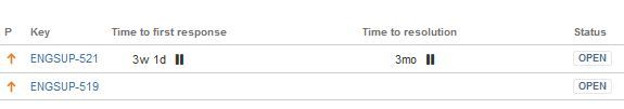

On JIRA Service Desk 3.6.0 some SLA "Time to first response" and "Time to resolution" are not displayed
What is is wrong to explain that

We are testing JSD,  When issue ENGSUP-519 was created I haved
SLA: Time to First response
Start: Issue Created
Pause
Stop   Comment: For Customers
       Entered Status: Waiting for Customers
       Resolution: Set
createdDate < '2017-08-01'     2000h   Sample 9-5 Calendar
priority = Hightest    16h Sample 9-5 Calendar
All remaining issues    129h    Sample 9-5 Calendar
SLA: Time to Resolution
    Resolution Cleared
Pause
Stop    Resolution: Set
priority = Hightest    90h     Sample 9-5 Calendar
All remaining issues    585h    Sample 9-5 Calendar
What is weird is that following
https://confluence.atlassian.com/servicedeskserver030/troubleshooting-sla-in-jira-service-desk-785326534.html
it seems that SLA not triggered
  issuekey  |         cfname         |
        textvalue
 ENGSUP-519 | Time to resolution     | {"timeline":{"events":[]},"ongoingSLAData":null,"completeSLAData":[],"metricId":5,"definitionChangeDate":0,"definitionChangeMsEpoch":0,"g
oalsChangeDate":null,"goalsChangeMsEpoch":null,"goalTimeUpdatedDate":null,"goalTimeUpdatedMsEpoch":null,"metricCreatedDate":1490377269575}
 ENGSUP-519 | Time to first response | {"timeline":{"events":[]},"ongoingSLAData":null,"completeSLAData":[],"metricId":6,"definitionChangeDate":1501772670909,"definitionChangeM
sEpoch":1501772670909,"goalsChangeDate":null,"goalsChangeMsEpoch":null,"goalTimeUpdatedDate":null,"goalTimeUpdatedMsEpoch":null,"metricCreatedDate":1490377269632}
(2 rows)
I was able to update the ticket SLAs with changing the ticket state to (OPEN/unassigned) and changing the SLA conditions to force the recompute
For example on SLA: Time to Resolution,
  • I added the stop condition "Entered status: Resoved"
  • I did save to recompute SLA
  • I removed then the condition "Entered status: Resoved"
After that SLA: Time to Resolution is ok on ENGSUP-519
Is there knew issues which can explain that ?

What is the criteria you have set up for your SLAs.  Perhaps some of the issues don't meet the criteria in the SLA configuration?
