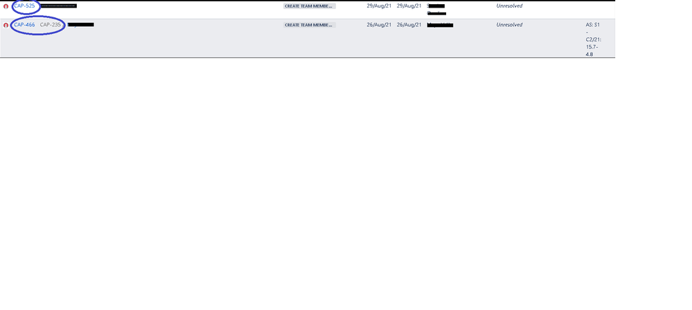

There is some thing strange while creating this sub-task -
I'm Attaching an image, which displays two issues from the same issuetype-
The first one has been created from the WF Transition,
The second one has been Created from the Create subtask jira button from the parent issue itself, and this one is linked to the subtask, the first one is not.
ללא שם.pngI appriciate all of your help !
Juan José Marchal Gómez
August 31, 2021
Hello,
ok...I know what is the problem now.
Null object appears because you have "other field" with null information during this action and the system is failing.
Actually is not failing this code, is failing other related code created in the past.
For example, imagine that you have a listener that assign a customFieldValue to other customFieldValue when the issue is updated.
When you are linking the task with the subtask you are "updating" the issue. If the first customField is without information, you can not assign null information.
So, my recomendation is that you check all the automations that you have related to this issuetypes (mainly listeners or other related creations) and try to focus the problem disabling all that you can to check it again.
Make sense?
Best regards!
