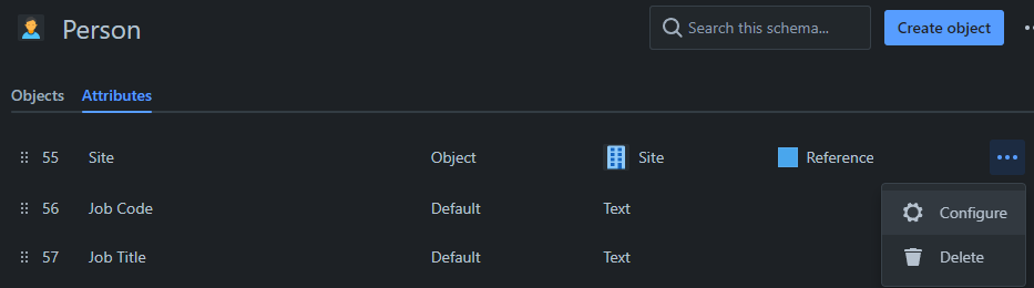

Rick Westbrock
April 4, 2024
We are on Cloud, the trick is that you have to do this on the reference attribute, not on the "target" object type.
In the example I provided above my Person object type has a Site reference attribute which is linked to the Site object type. I click the meatball for the Site reference attribute and select Configure which is what displays the dialog box with the "Include Children" option.

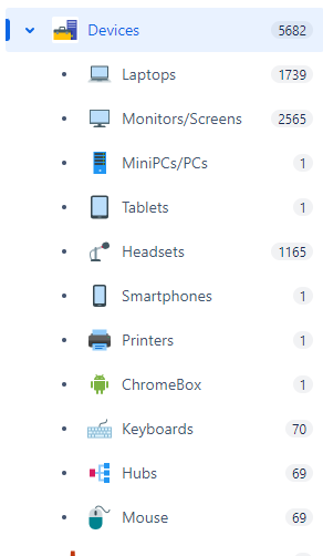

José Nogueira
January 25, 2024
I know this is quite an old topic, but here is my input in case it fits anyone.
For CLOUD version I have a similar case, but approached it in a kinda mix of both options 1 and 2.
DEVICES object set as (equivalent to the here mentioned LOCATION):
- abstract
- pass all attributes to child object types
- have an attribute to label/ID as in the child objects (as per my sample e.g. Laptops, ...)
- has all the required attributes for all child objects
CHILD objects set as:
- having DEVICES object as parent
- no distinct attributes among any (attributes are filled as per CHILD object's requirements - hence, some are empty on child A but filled on child B... this can be tricky to validate though)
As we can see in this pic from my Sandbox trial envoronment, all child objects are automatically replicated in the parent object, and those can be reached from either querying a child object, or the parent one (filtering by the label/ID attribute if needed).
Hope this helps someone
Cheers
