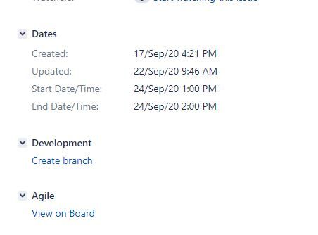

I need help with creating a filter. I tried but It didn't work. I have two custom date/time fields "Start Change Date/Time" and "End Change Date/Time".  When users create tickets they schedule their change by selecting date and time for example Start: 21/Sep/20 10:00 AM and End 21/Sep/20 11:00 AM.

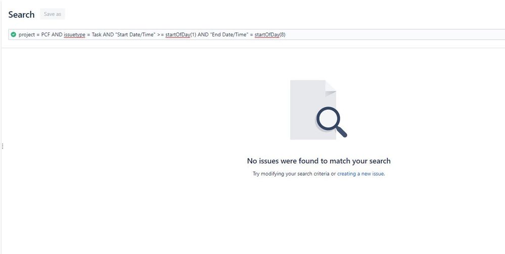

Thank you @Kat Warner I tried the above method but for some reason, it is displaying "No issues were found to match your search". There are 7, 8 issues. I'm including screenshots that might help.
I'm looking at the logic, that tickets have a start date/time Tuesday time is greater than 9 am and the End date/time next Tuesday time is equal to 8:30 am.
Here is the query:
project = PCF AND issuetype = Task AND "Start Date/Time" >= startOfDay(1) AND "End Date/Time" = startOfDay(8)
Appreciate your help, thank you,

I changed the last equal to less than equal and it works. Now, how I can add time, like start date/time is greater than 9 am Tuesday, and the end date/time is equal to 8:30 am next Tuesday.

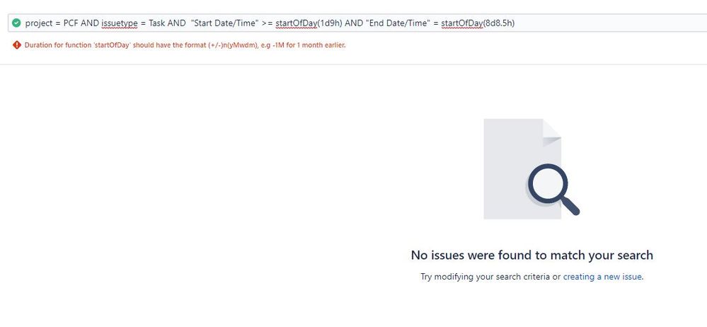

You may need to experiment along the lines of:
"Start Date/Time" >= startOfDay(1d9h) AND "End Date/Time" = startOfDay(8d8.5h)

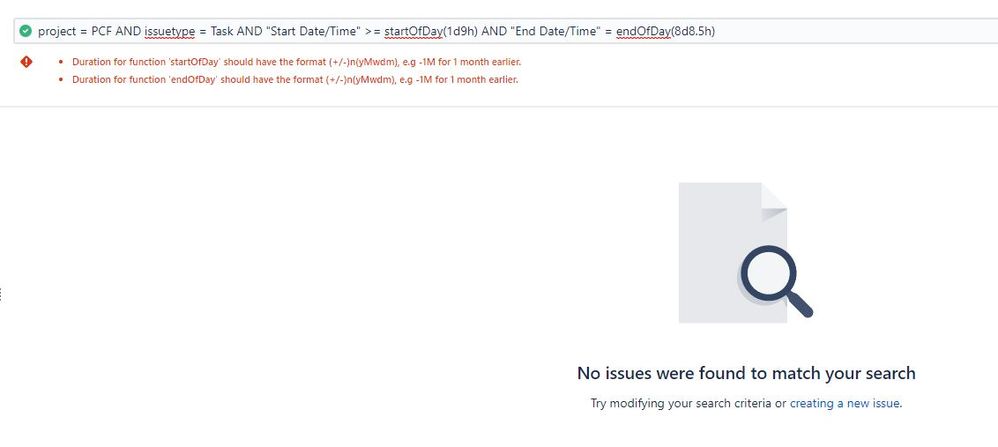

Hi @Kat Warner I tried your given query but for some reason, it is displaying an error. I tried the following both queries
project = PCF AND issuetype = Task AND "Start Date/Time" >= startOfDay(1d9h) AND "End Date/Time" = startOfDay(8d8.5h)
project = PCF AND issuetype = Task AND "Start Date/Time" >= startOfDay(1d9h) AND "End Date/Time" = endOfDay(8d8.5h)
