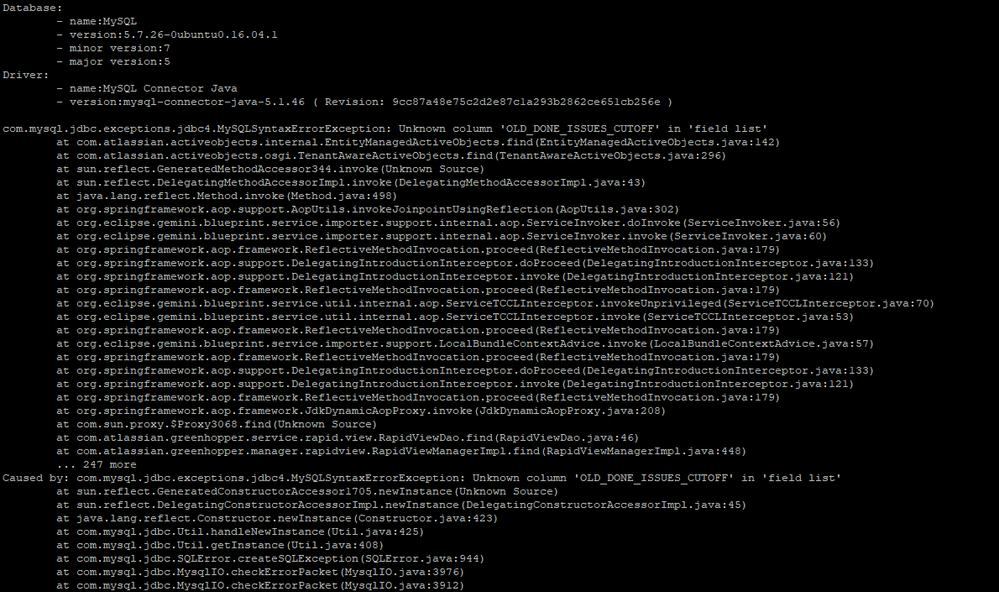

When I performed the backup restore as instructed on the atlassian documents I get this error:

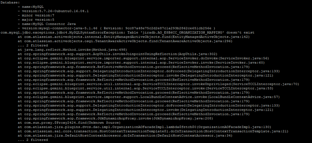

image.pngUpon checking the atlassian-grasshopper.log I found this:image.png
I also checked atlassian-jira.log and got this:
